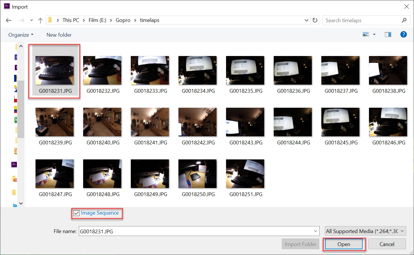

Try this method to import your image sequence:
  1. Go to Window > Media Browser.
  2. Click the context menu (the three lines) and enable Import as Sequence.
  3. Then, go to File > Import and select the first image in the sequence, then click Import.

The naming of the files can be critical. Place them in a folder and rename them so the first file has the name 0001.jpg, the second 0002.jpg, etc, etc. Try that and make sure that Image Sequence is checked in the import dialog.

Naming your files is very important.
As mentioned earlier The Bridge does a wonderfull job in renaming, and keep it simple.
Don't need to start at 0001 as long as it sequential.
