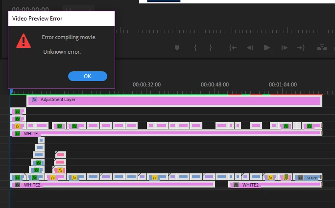

ellen_wAuthor
January 3, 2020
Well, about 2/3 of the way through the render, I got this:
