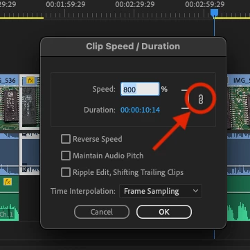

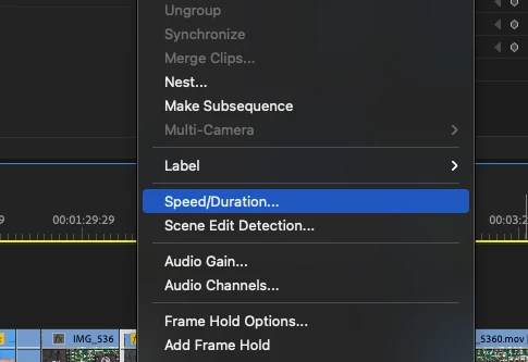

    June 3, 2023
    I think I found a solution:
    Select the clip you want to work with (make sure video and audio are selected), right click, hover over the drop down arrow until the "speed/duration" option apears. Select the percentage of speed you want to increase and make sure the link icon is set to "linked"
