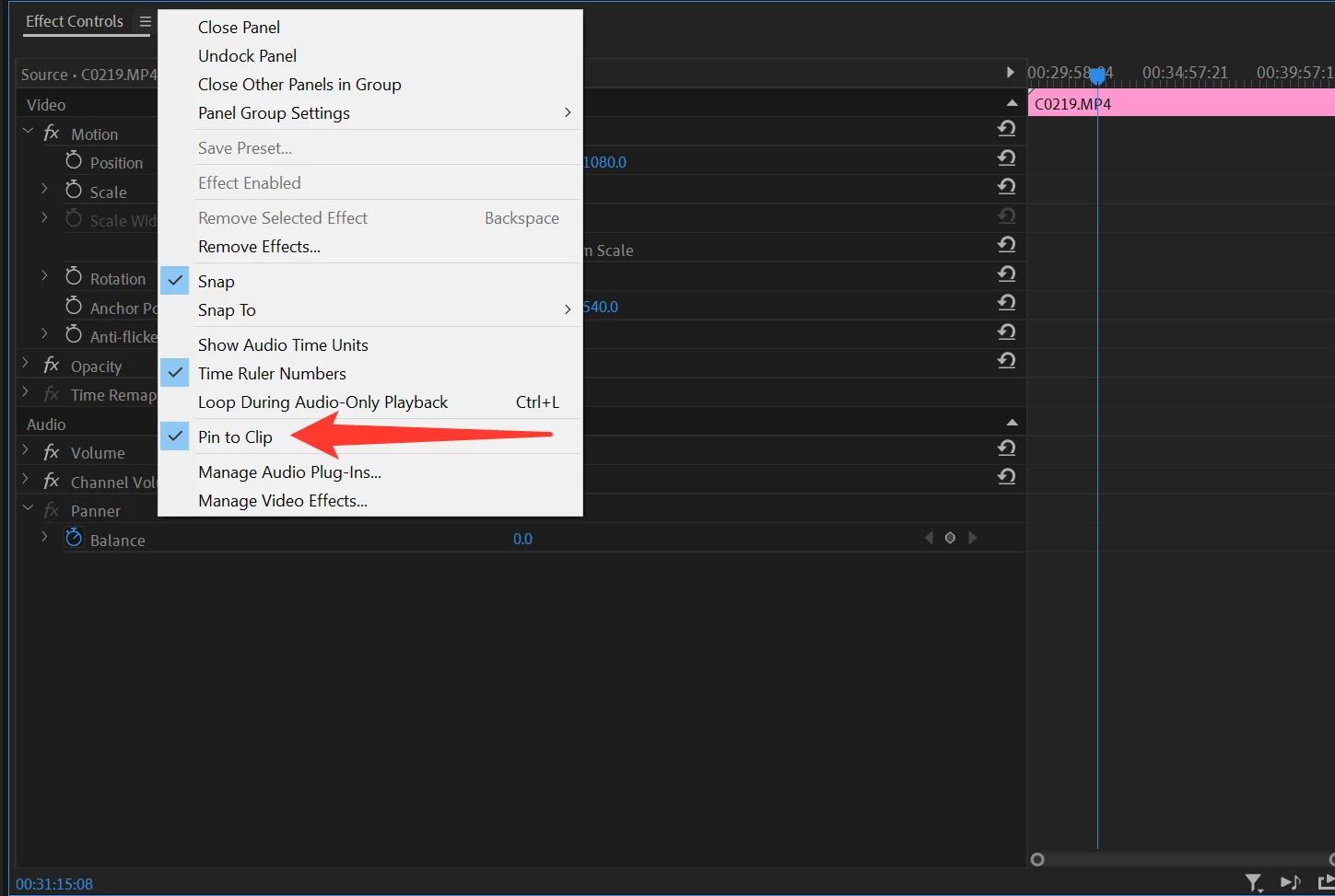

Without screenshots, it's hard to say for sure, but are you talking about keyframing in the Effects Controls panel when you have a transition between two clips? If so, you can click the flyout menu of the panel and disable the "Pin to Clip" feature.  If this isn't what you're referring to, please be more specific and provide screenshots.
