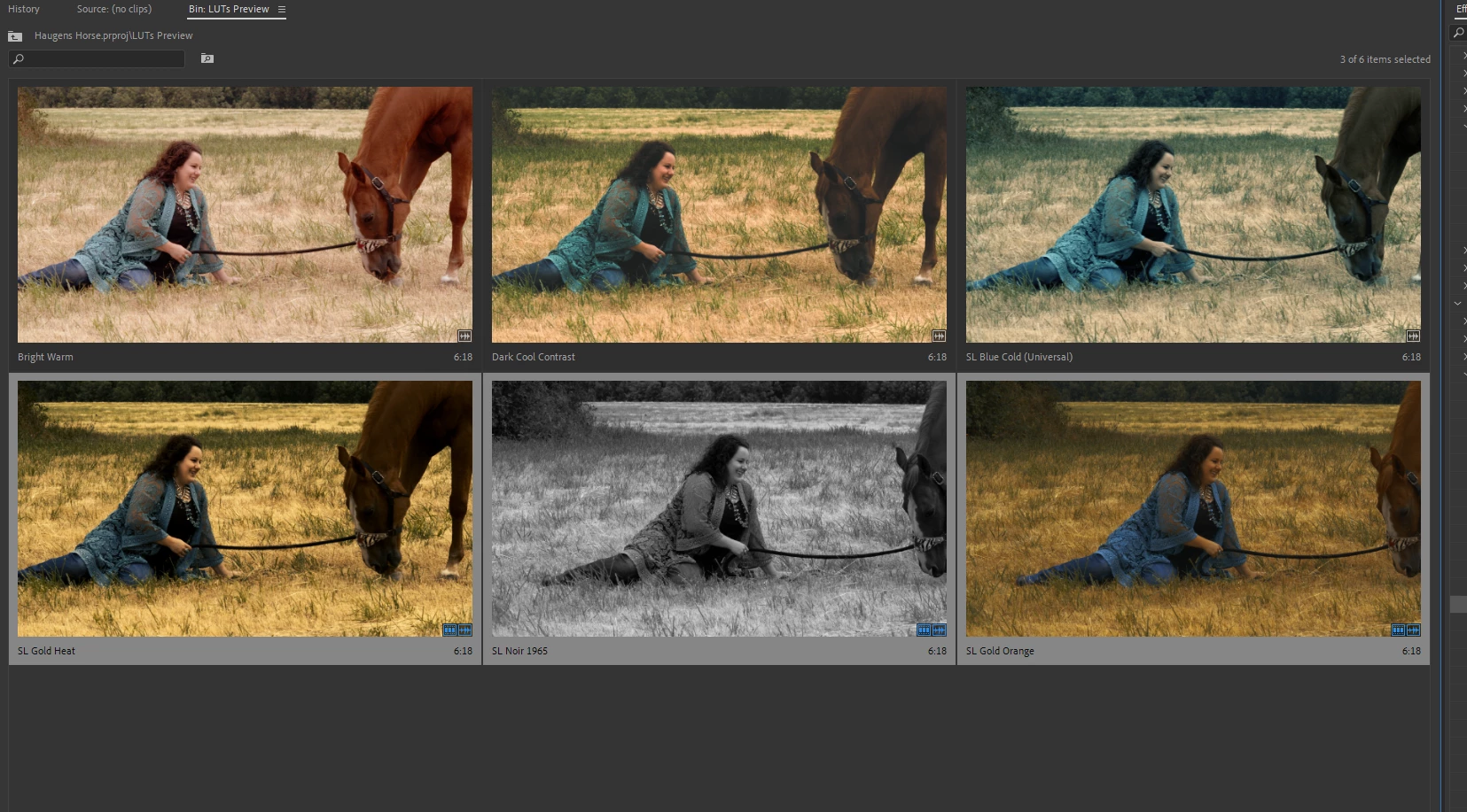

Here's another possibility within Premiere ... create a new bin, call it say LUT Previews.
Copy a clip to the new bin. Drag to apply to a timeline. Apply the LUT via Lumetri to the Master Clip tab of that clip. This should now show on the clip in the bin. Rename the clip to the name of the LUT, and set a poster-frame on the view of the bin in thumbnail mode in the Project panel.
If you either use a number of clips or duplicate one numerous times, it should work. It would give you a preview of that LUT applied on one of your clips.
Alternatively, copy a clip and then paste it X number of times in the LUT Previews bin. Drag/drop a LUT onto each from the Presets bin. Rename the clip for the LUT applied.
With that process, it's fast to get the LUTs dropped on a clip ... but the image doesn't stay solidly with the LUT in place in the Project panel. So to fix that, select all the clips. Drag/drop onto a sequence. For every clip, go into the MasterClip tab and touch the Lumetri controls without doing anything. Then just delete them from the timeline.
You should have a bin of LUTs applied to the selected clip that you can view in thumbnail mode.
And should look something like this ...
Neil

R Neil Haugen
R Neil HaugenCorrect answer
January 25, 2020
Jim,
Yea, being able to set a thumbnail view would be so incredibly useful. Resolve has a nice way to store complete grades, not just LUTs, on a 'page' so you can quickly reference them to choose. I do wish we had that here.
Neil
Everyone's mileage always varies ...
January 25, 2020
Nice tip, Neil.  Looks like a workable way to get an idea of how the different LUTs are affecting footage.

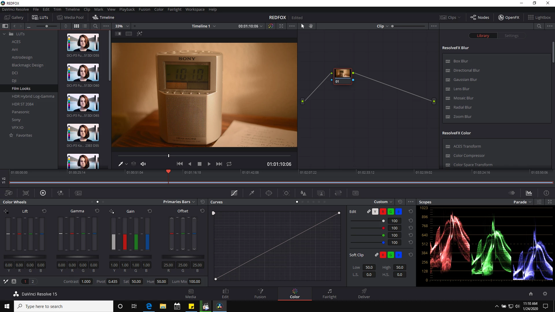

January 24, 2020
In Resolve 15 there's a panel of LUT 'gallery' stuff you can open. This sample is from laptop (not much real estate for real editing via small screen).
you put mouse over thumbnails of LUTs or LOOKS and can scrub through the thumbnail to see effect on program monitor. However, you have to deal with cleaning the node if you happen to 'apply' that LUT to get back to your original.
I like the gallery stuff in a way, but mostly I like making my own LUT ( if necessary ) using the original stuff and color controls ( and luminance controls which to me is more common a fix than color correction )
The LUTs are just someone elses correction based on god knows what original stuff, and saved as a 3d LUT ( standard extension for sharing ).
Better off ( IMO ) doing correcting on a clip and then save that and apply it broadly to all clips... and then subsequently adjusting all clips so it looks nice to you.
