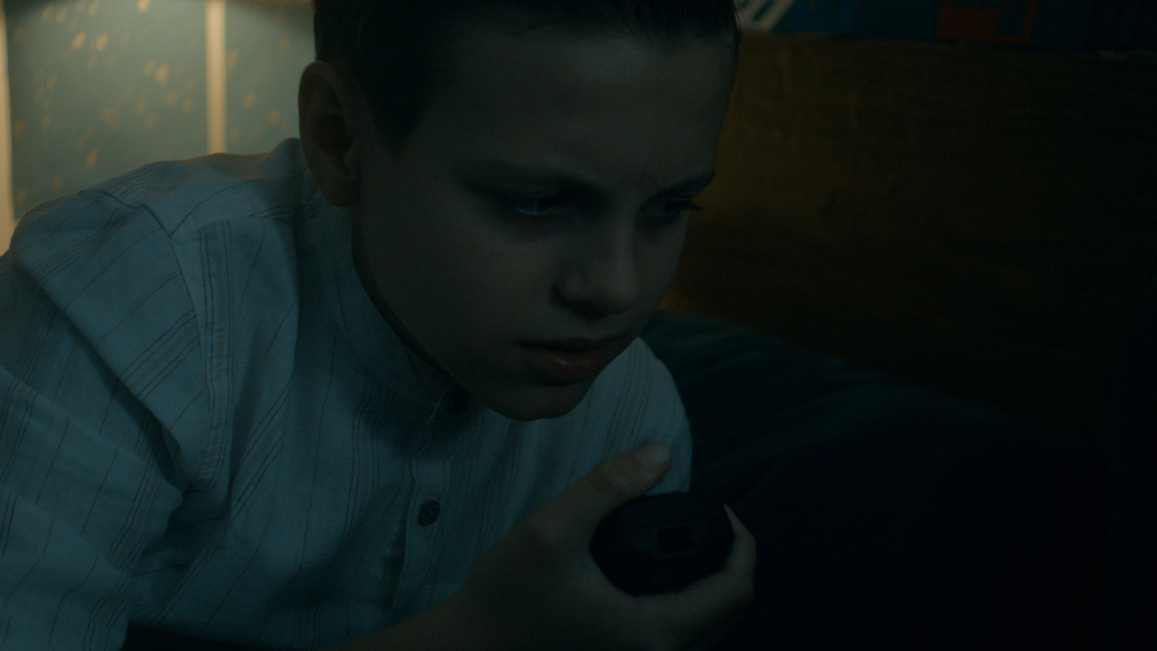

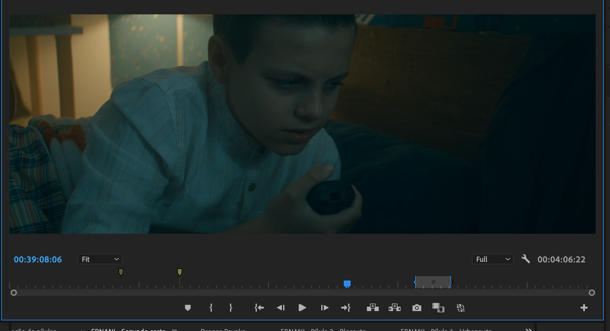

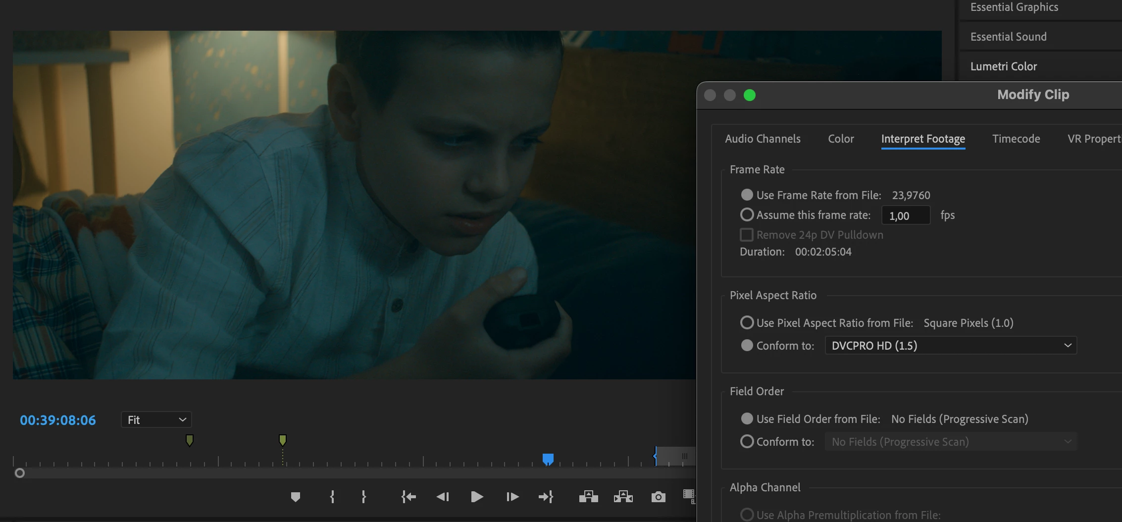

I have a sequence with anamorphic 1.5x footage which I already interpreted as this (DVCPRO HD 1.5) and it's all fine while working inside project and exporting as video. But when I try to export a frame - the photographic camera icon tool below the preview screen - I end with a non-interpreted frame as anamorphic, de-squeezed like the print attached.
How can I export frames to be exactly as the sequence shows?

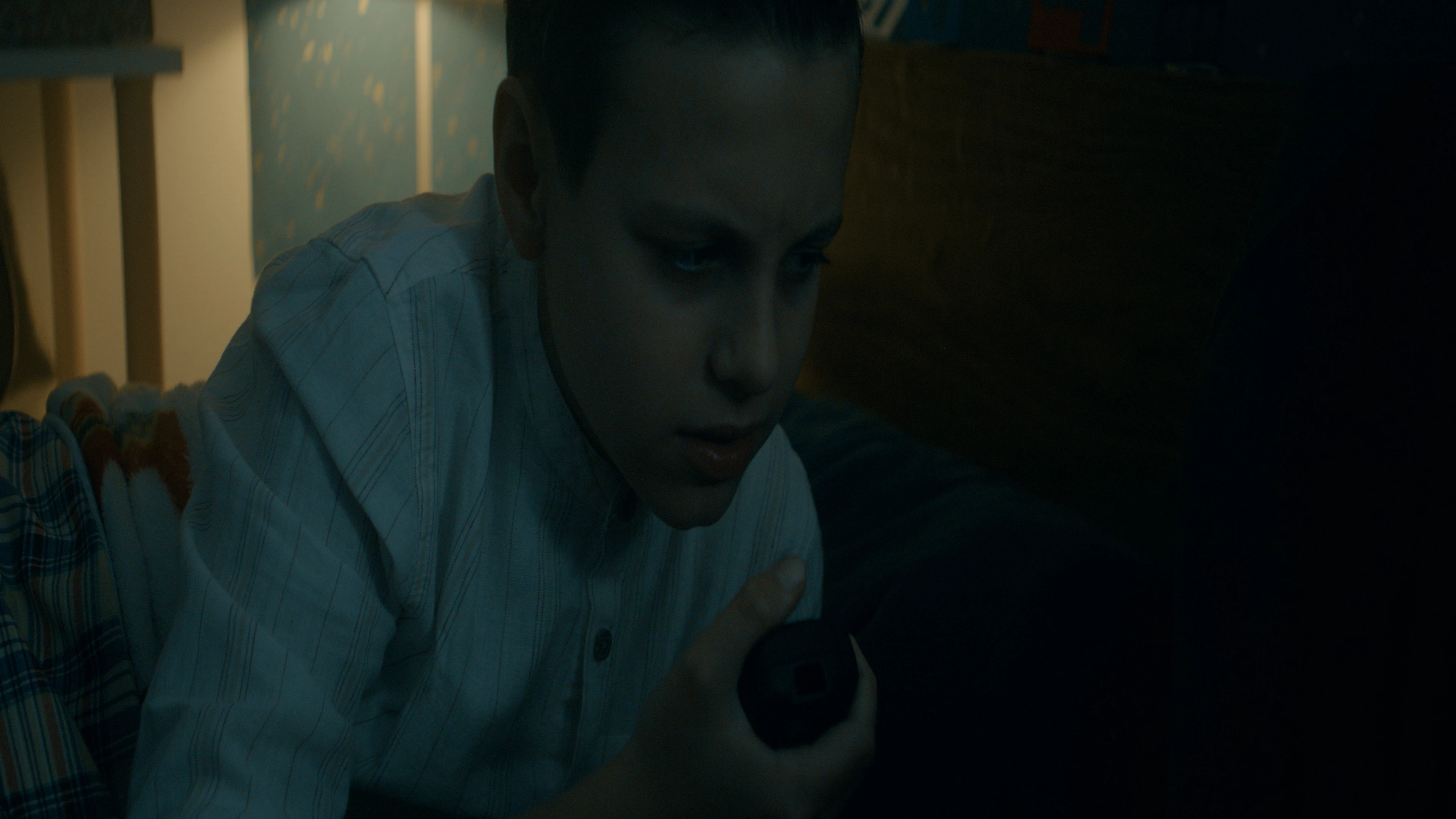

Hello, thanks for your response. I did it and, despite it corrected the squeeze aspect, the frame appears to be 16:9 and not anamorphic. The frame is cropped.
