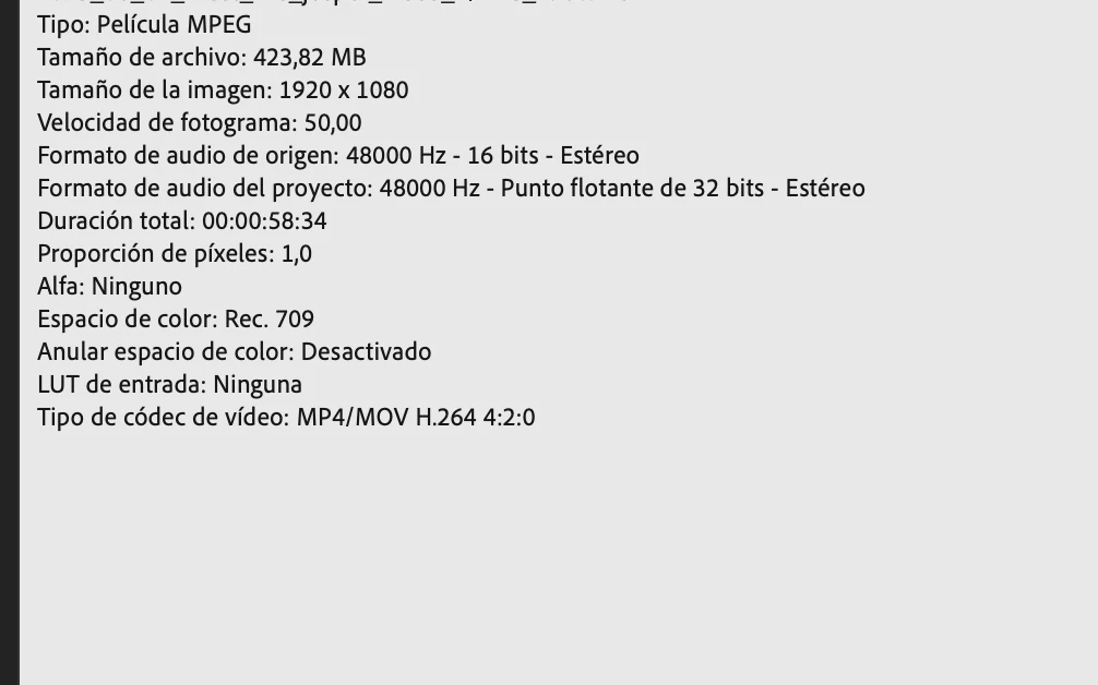

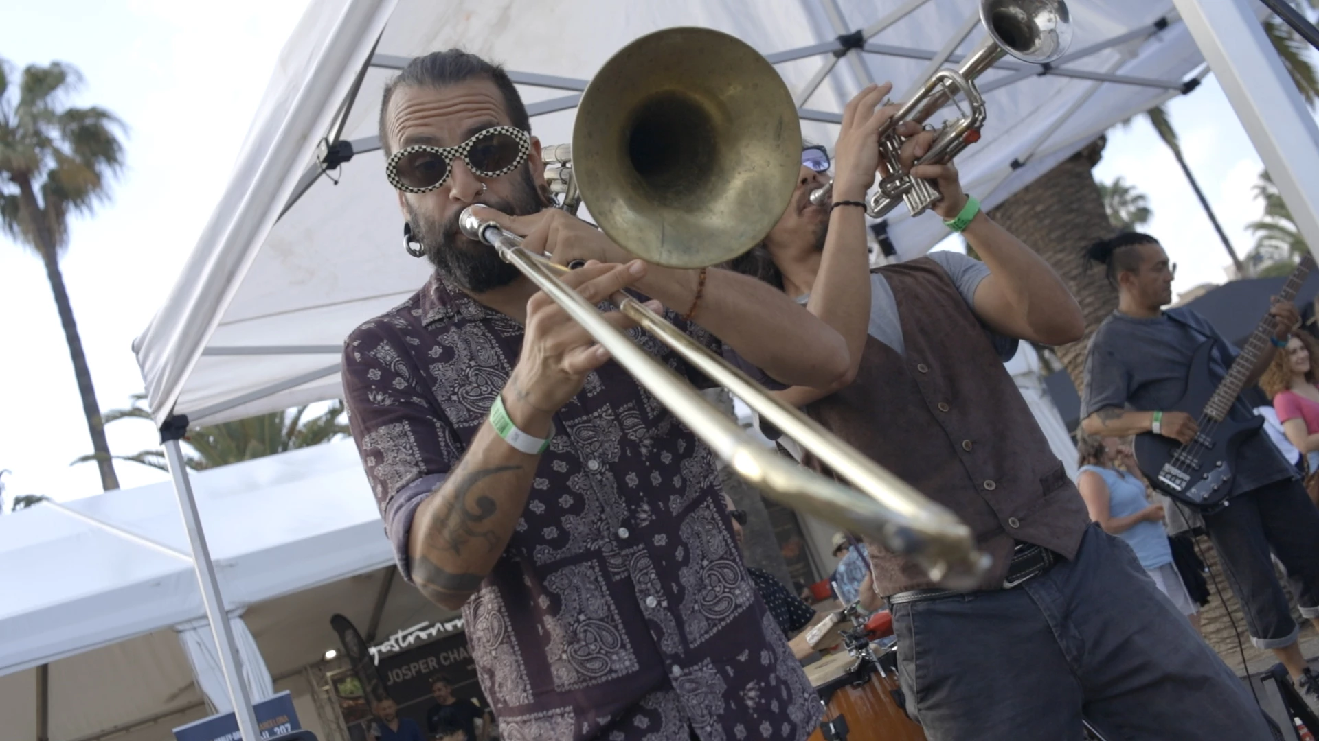

Hello, I have a problem with color management when importing videos that I recorded in C-Log with the Canon 5D Mark IV into Adobe Premiere. The imported videos appear as if an AUTO LUT has been automatically applied by Premiere. I can't see the videos as I recorded them, with their original color and contrast. When I check the properties, it indicates that the color space is REC 709. I can't revert back to the original video I recorded. I'm attaching photos to show the problem, and I would appreciate if someone could clarify this doubt for me. Thank you.

I've sent you a DM, asking for some sample footage and what version of Premiere Pro you're using. I believe the answer to your question is very simple (you probably just need to download and apply a Canon LUT to the footage) but I'd like to double-check.
Fergus

I'm using: Adobre Premier Pro version 23.4.0
Fergus H
June 8, 2023
Thanks.
Please check the direct message I sent you.

Hi Neil, first of all, thank you for your response. My level of Premiere is not very high, so I don't know much about settings. I don't quite understand what you mean by the math example. I know that I need to use a LUT to achieve the right color. The problem is that when I use the Canon Mark IV (CLog) in Premiere, it automatically corrects the contrast and slightly changes the color with more saturation. I have worked with some videos recorded with Sony, and it doesn't apply this automatic correction. Could it be that the CLog file is the issue, and I should use a more up-to-date file type? Thank you.

With the auto-tonemapping option "on" in sequence settings, what do your C-log clips look like?
I'd love to see a sample  ... drag/dropping a screen grab onto the test reply box would be super!
