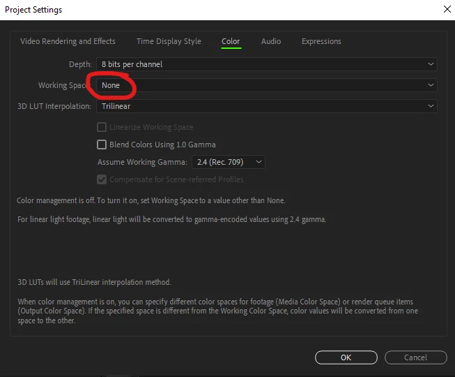

I figured it out!!
You gotta turn off color management in the After Effects project file of the mogrt then re-export the mogrt.
Go to Project settings then change Working space from sRGB to None.

I figured it out!!
