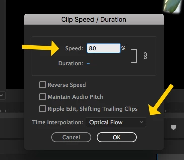

    That is not correct. 60i is 60 interlaced fields per second, 2 fields per frame, at a frame rate of 29.97. If you want to slow it to 24 fps, then you would slow it to 80% speed.
    If you right click on a clip in the timeline and choose Speed/Duration from the drop down menu, you can use optical flow for time interpolation.
    Another option would be to Interpret the clip frame rate using Modify > Interpret Footage.

    You've tried it with Optical Flow selected?
