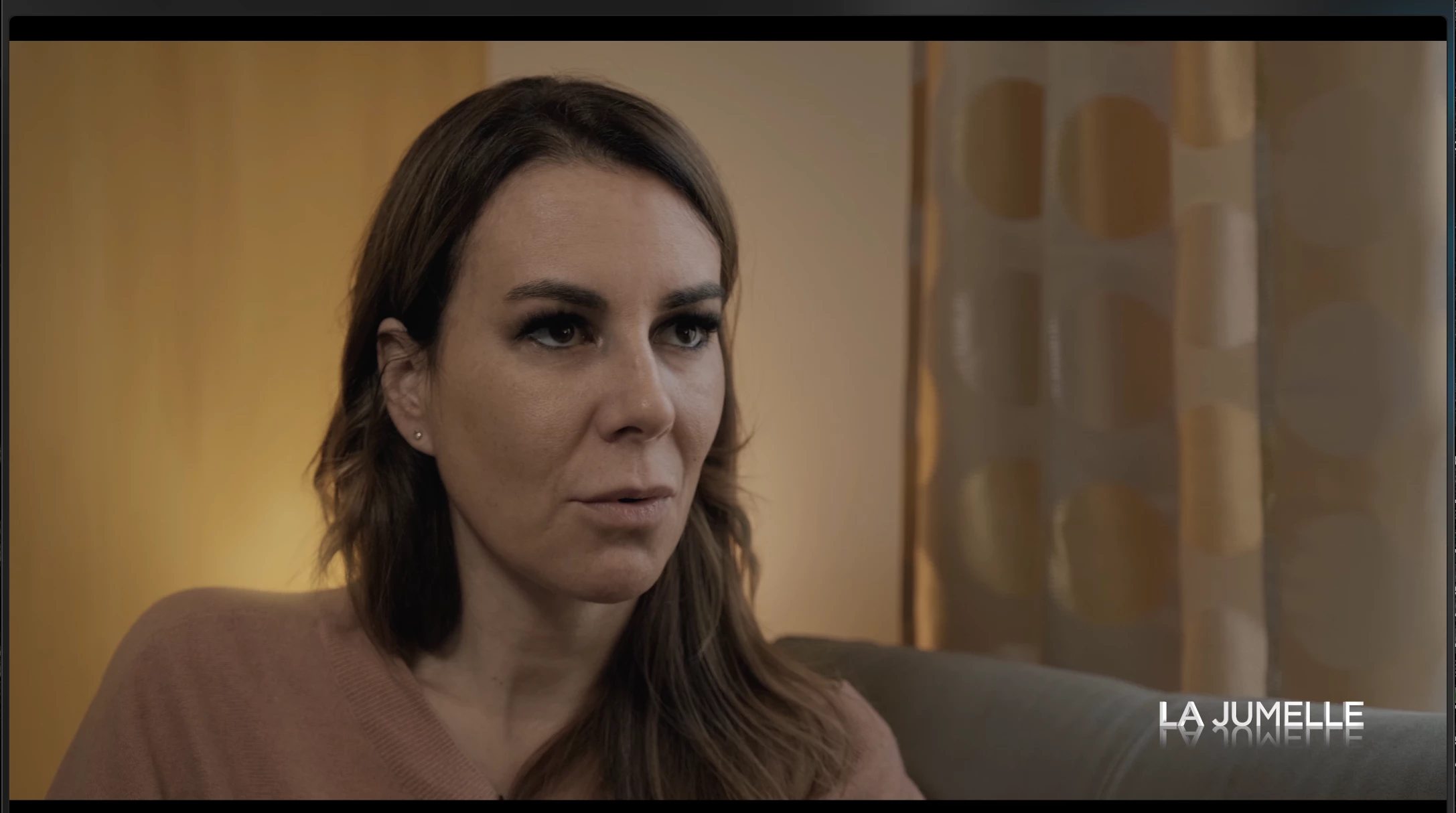

Hello, I have exactly the same problem.
This is the calibrated image in PREMIERE PRO.

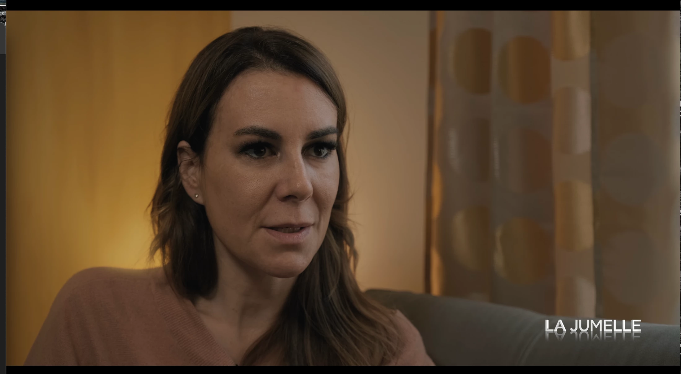

And here’s the export.
Can you help me with this, please?
