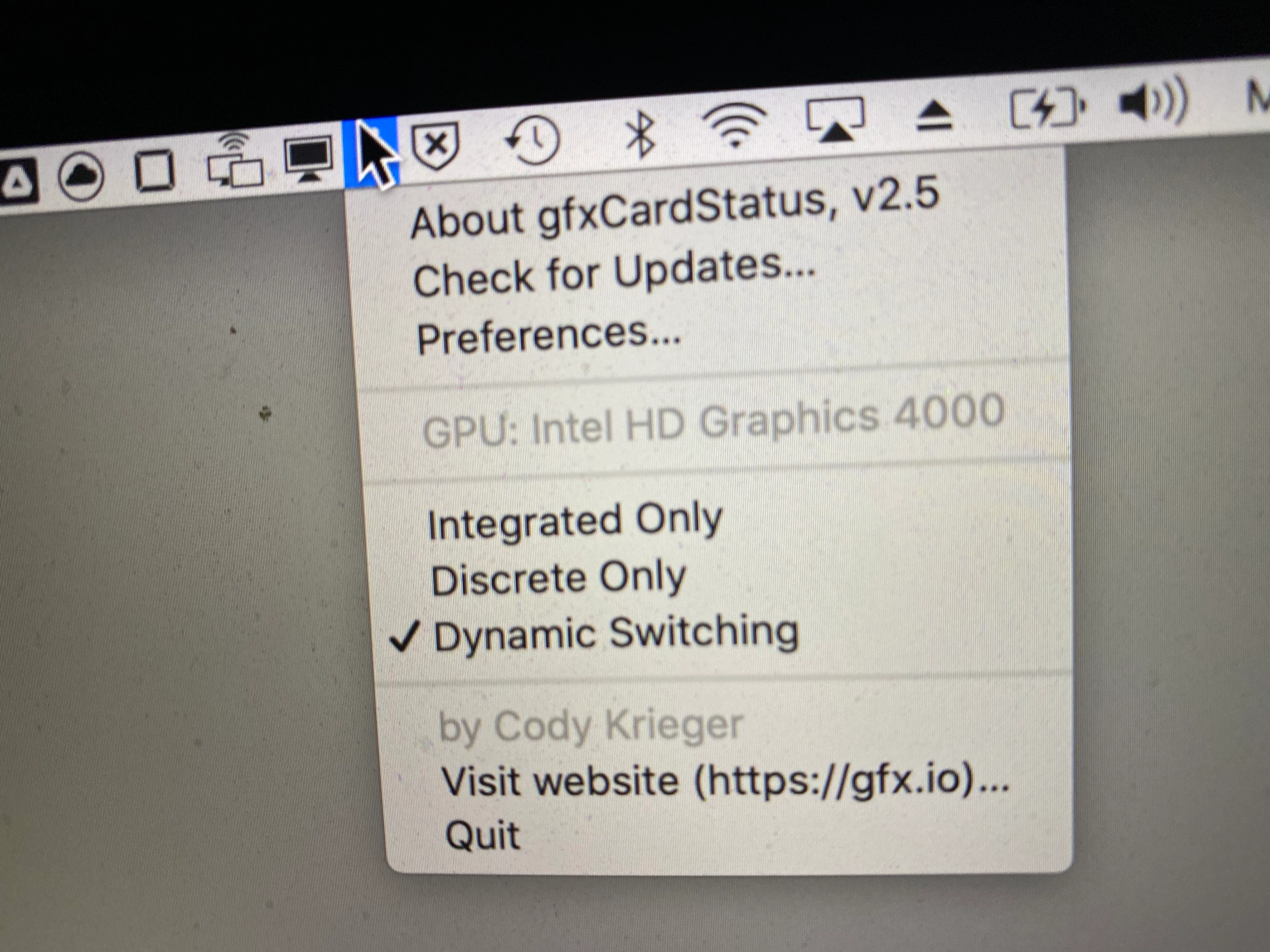

@Hugo18860241ybod, you might give gfxCardStatus a try to bypass macOS's Dynamic Switching.  I found that to be helpful after NVIDIA driver support was dropped for macOS.  So, you'd be using the integrated Intel Iris Pro 5200 instead of the dedicated NVIDIA GeForce GT 750M with Premiere Pro 2023.  Although, the Intel Iris Pro 5200 no longer meets the graphics requirement either.
