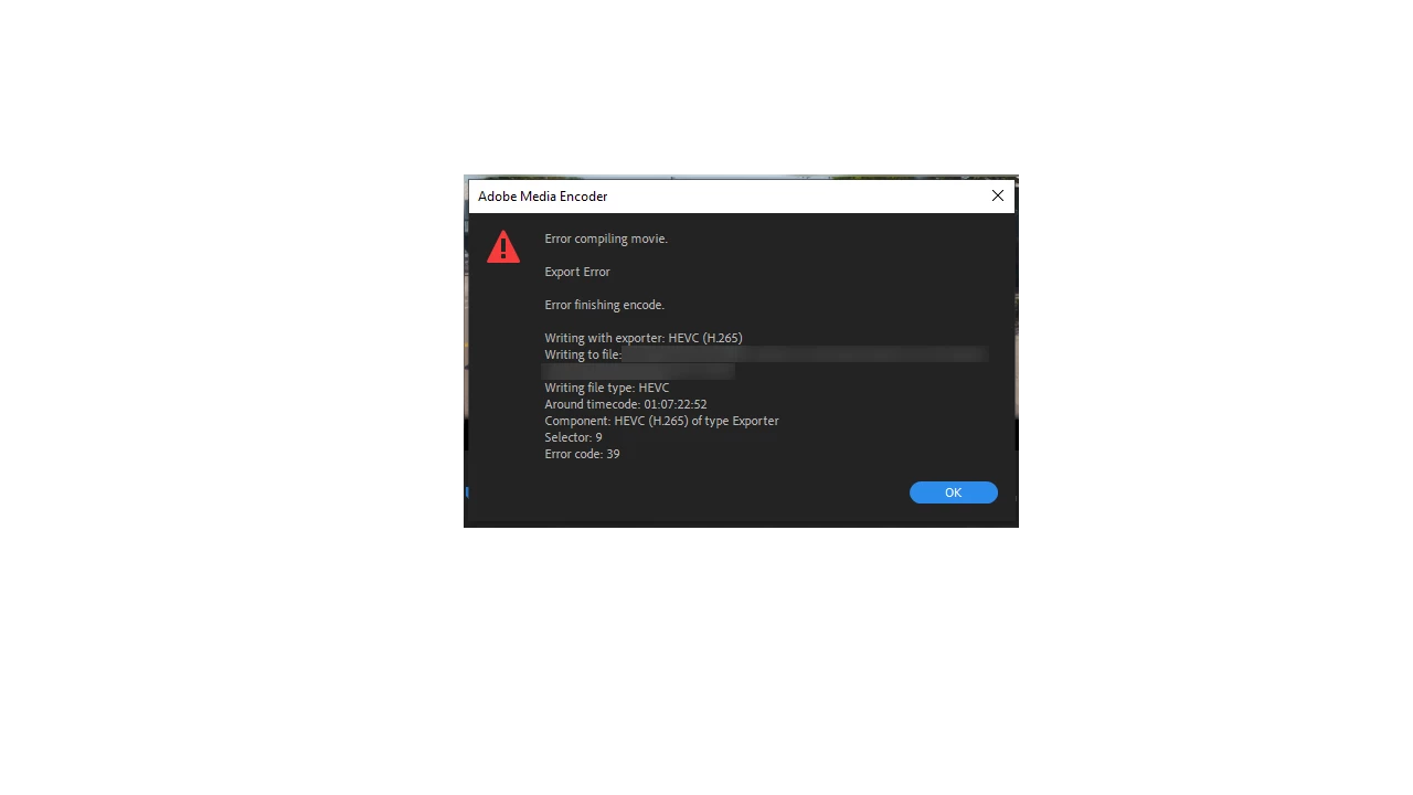

Problems with exporting my video. "Error code 39"
This is a little bit of both a bug report and discussion, but I put it under bug report because that's the closest it's going to get about this topic.
The known issue of NVIDIA and Premiere Pro not working together and crashing has been causing me more issues than just crashing. I first ran into error code 39, then it started giving me other errors that I don't exactly remember what they said, though it exported 1 video 3 times when I clicked export once, and all of the videos were corrupt files. I also ran into this problem last night while trying to export the same video, waiting around 10 minutes for the 100% to go away and give me the notification that it had been exported, but I got tired of waiting, tried canceling, and Premiere crashed.
Does anyone have any possible solutions to this?

I received this error recently. I spent hours troubleshooting and finally found a solution
The issue I had is that my harddrive/storage was full. I deleted some files and the file exported successfully. Right click your harddrive and select properties(windows) and make sure you have enough space for the new exported file to save on the harddrive. I recommend freeing up double the space of the new file.
Let me know if this works for you. Happy Editing

My movie I'm trying to render is about 4 hours long and rendered at 4k. I've rendered it already at lower resolution without error. I'd really like to render it at 4k though. I'm not sure what i can do next. Maybe there is a way to make 4k but lower quality or bitrate or something??? It gave the error code sometime after it already reached 100% Thanks for any help i can get!
-----the text says:-----
Error compiling movie.
export error
error finishing encode.
writing with exporter: H.264
writing to file D:\movie.mp4
writing file type: H264
Around timecode: 04:08:31:16
Component: H.264 of type exporter
selector: 9
error code: 39

May 3, 2023 4:17 PM UTC
I changed the export location and that helped me with this issue.

Same.  I have spent HOURS on one video and cannot get it.  The first time it exported and uploaded but there was no sound.  Now it will not even finish exporting.  It shows 100% and then flips to an error.  I have watched all kind of YouTube videos for help.  Why does my video play fine on premier pro after editing, but not export and play?  So frustrating.  Any ideas?
Apr 27, 2023 11:50 AM UTC
Update... it worked! The video has successfully uploaded with no error 39 message. Once again... no adjustments were made to the export settings. The solution is to either save the video to a different drive, or free up more space on the drive.
Apr 27, 2023 4:16 AM UTC
So I've been getting this message as well with a recent video that I've been trying to export. I have it as an HEVC (H.265) however, so h.264 isn't the problem. What I have discovered is that my hard drive is near full capacity with only 116 GB available (before exporting the over 1 hour long 5K video) and I just didn't realize that my hard drive was that full before. I'm no expert, but I read one time that in order for premiere pro to export a video successfully, it needs double the space on the drive that it's exporting to then what the finished video would be. My finished video is going to be slightly over 60 GB... I only have 116 GB of space available... there it is.
When Premiere Pro exports a video it needs space on the hard drive that it's exporting the video onto... or so I've read in the past. I haven't had this problem in a while... I've used Premiere Pro for 3 straight years on a nearly daily basis, but I do recall running into this issue before thinking something more serious was going on when in all reality, I just needed to clear up space on my hard drive, or write the video to an external hard drive so that there is enough space for Premiere Pro to work with.
So... With that said... I'm using an external hard drive with 2.6 TB of free space. That should do the trick. 3% done at the moment, so I'll have to check 7 hours from now as this project is massive in size. By the way, you guys should try exporting in H.265 rather than H.264. Videos get exported a lot quicker that way. I've done it successfully at H.265 for a few months on multiple videos at this point at 5k 60fps so I really don't feel like that's the issue.
Once again, try checking your available space on the drive that you're wanting to save the finished video on. It's possible that the recent updates have forced Premiere Pro to require more available space on the drive that you're saving the file to... but... I really don't know if that's true or not since I'm not an expert... but I am experienced and I feel really confident that this is the issue that many of you are facing. Others have reported that selecting a different drive has solved the problem for them, and I'd be dumbfounded if that didn't solve the problem for me. If you don't have a seperate drive to save a project on, or if you can't free up some space on your computer, then I suggest to invest in an external hard drive for any situation like this that you come across in the future. Plus, if you're going to be editing a lot of video in the long term, an external hard drive can be very usefull.
Apr 25, 2023 8:41 PM UTC
Not sure if anyone is still having this issue, but I found that I was getting the error only when exporting with "Match Source-Adaptive High Bitrate" selected. I was able to successfully export my project by just selecting "High Quality 1080p HD." Hope this helps if anyone's still having trouble!
