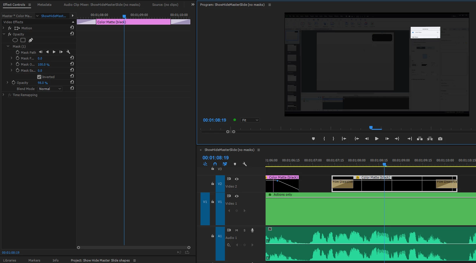

I'm using PP CC 2017 and I'm running into two issues that I can't seem to resolve. I'm creating a video tutorial and I want to draw attention to a something in the software so I created a black color matte, placed it on video track 2, changed the opacity to 98%, added a mask to the color matte, positioned the mask to the area I want to draw attention, set the mask to invert, and added film dissolve transition on both sides of the matte so as the video plays the area outside the matte becomes dark.

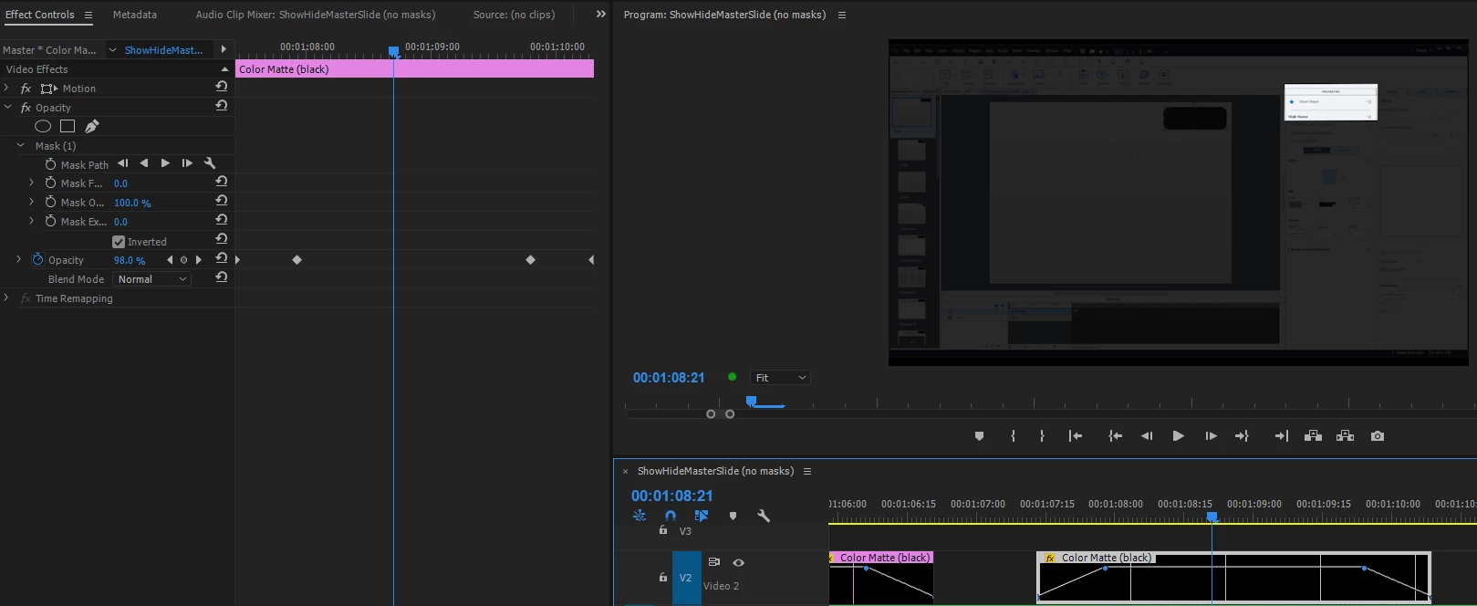

The issue I'm seeing is that when I'm playing back the video the screen flashes white for one frame as soon as the timeline hits the color matte in the timeline. If I stop playing the video and backup to just before the matte then it doesn't flash. The same thing occurs when I'm just scrubbing the timeline and after the flash of white the matte doesn't do it anymore.
I wouldn't mind the flash except that it appears in the final render as well. I've found that the problem only occurs when I'm using a combination of a mask and a video transition. If I delete the mask or delete the transition, then the flash doesn't occur. If I remove the transition and keyframe the opacity so it's doing the same thing as the video transition, then the white flash doesn't appear.
Obviously I would prefer to just use video transitions than having to change the opacity key frames for each matte, but I can't come up with any reason as to why it's having this problem.

    Correct answer excited_Genie16B8
    Go with that.  Make the effect a Preset for ease of use.

    excited_Genie16B8Correct answer
    December 15, 2016
