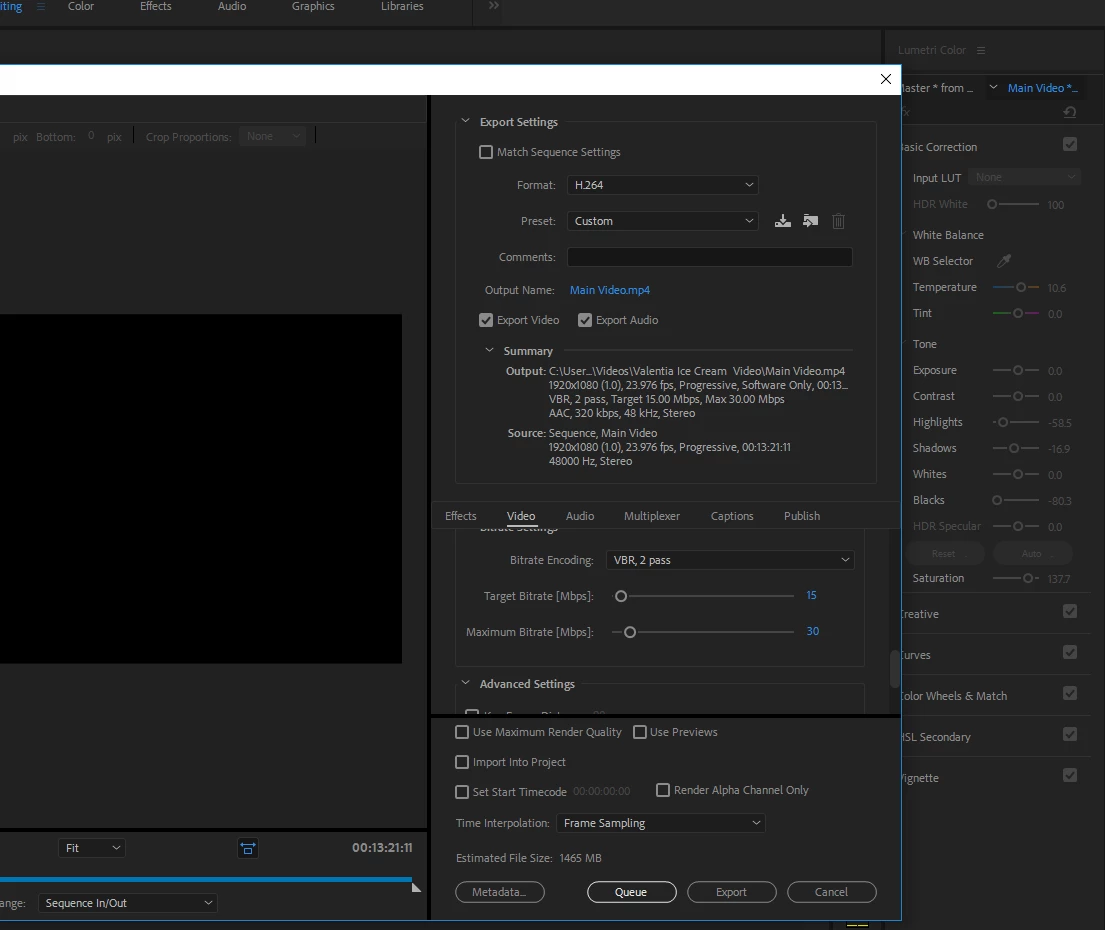

    April 16, 2018
    Thanks Jeff, I'm not sure if this screenshot is clear enough. I think I got the bitrate settings, from a Youtube video which basically said "turn them up as high as they can go".
    For the most recent export, made 10 minutes ago, I have used much lower setting of Target 15 and Maximum 30. I have to say I don't really understand bitrate settings and how to use them correctly.
    The other main settings are H.264, 1080p and VBR 2 pass, exporting as an MP4 file. If I need to change anything or add anything, I'd welcome the advice.
    Stephen
    SAFEHARBOR11Correct answer
    April 16, 2018
    Screen shot is perfect, click on it to see full-quality version.
    Strange, when I had tried H.264 export here the max bitrate allowed was 50, but may depend on the preset you start with. Make sure you are not looking at the AUDIO bit rate of 320kbps.
    Bit rate is basically how much bandwidth the file uses per second. Please keep in mind though that you can't make something look better than it did to start with! Meaning most video cameras using AVCHD recording for instance might use between 24mbps to 28mbps quality. If you edit that file in Premiere, and export at say 40 or 50mbps...the video is not going to look any better than it started out. So really, exporting at higher bit rates creates a larger file than the original, but without much if any benefit.
    Maybe put the Target and Max numbers closer together to avoid huge spikes in data rate which could cause playback issues. Like 15 and 20 rather than 15-30.
    Thanks
    Jeff
