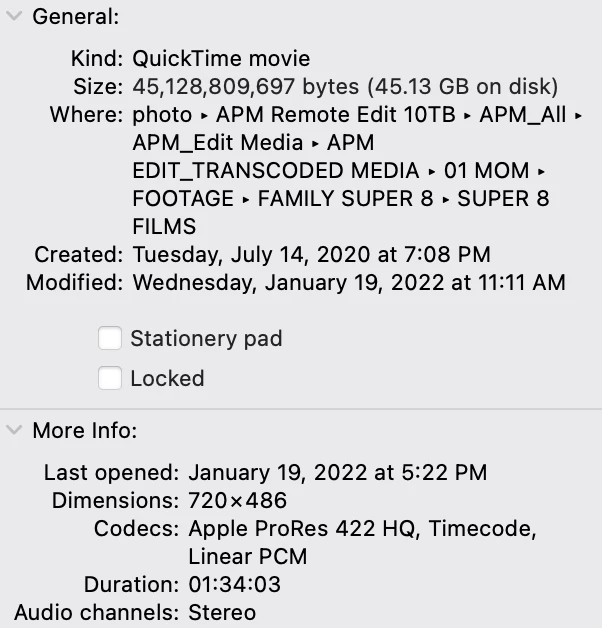

I am working in Adobe Productions on a long form documentary. The editors move sequences across projects within the production. We have found that copy and pasting sequences from one timeline to another whether it is in the same project or another causes infiinite beach balling/hanging and crashes. This happens with copy and pasting, but also with bringing in media through the source monitor or media browser, or importing sequences.
We recently have been able to narrow it down and realized that this issue is specifically prevalent when copy and pasting clips that were digitized from super 8 film. I tried re-encoding the clips to a slightly different custom Prores codec but it did not help the issue.
Here is the information on the clips:
720x486
Codecs: Timecode, Linear PCM, Apple ProRes 422 Proxy
Color profile: SD (6-1-6)
If anyone has been able to sucessfully solve a similar issue I would appreciate any suggestions.
