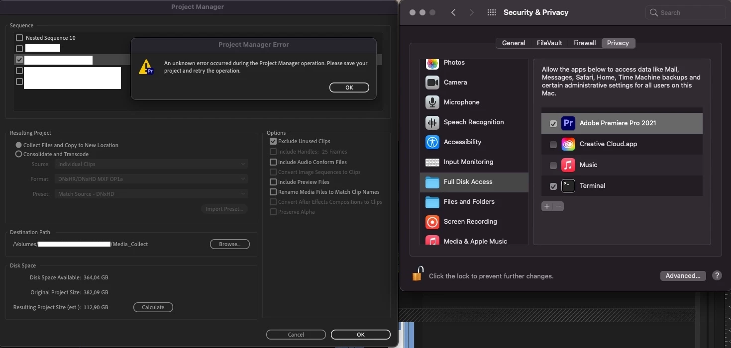

Project Manager 15.4.1 - ERROR with copy braw footage. MBP M1
  • September 24, 2021
  • 4 replies
  • 1547 views
As the subject says, also see the screenshot for settings (just copy files and exclude unused clips).
It does work with .mp4 and .mov but not with .braw

The issue comes from the Blackmagic RAW free plugin. It's a known error from a long time, still not fixed.
There are 2 third party paying choices you could use here to solve the problem.
Best,
Nicolas from Autokroma

Making a new project and copying the sequence over also did not help - the result is the same.

This is the one I'm using, thanks.

I've also renamed everything (some folders and a sequence) so there wouldn't be any "obscure" characters (like õ,ä,ö,ü - very common letters in Estonian). The result is the same.
