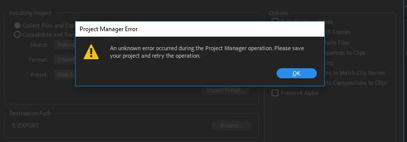

Wondering if anyone else has had the same issue. Im trying to move a project from my MacBook to my iMac using the method of Project Manager; Collect files and copy to new location.
But every time I try this I get a error message saying "an unknown error occurred during the project manager operation. Please save your project and retry the operation". I tried that and still no luck.
Anyone able to shed light on the situation would be great. Or is there another way to move the project easily?
Many thanks
Dan
    TerrykingCorrect answer
    May 1, 2025 1:24 AM UTC
    2025, Had this issue just recently. I unticked the [include Preview Files] and it worked just fine.
    How my issue started: I have a pretty large project with tones of edits in them but I wanted to share just one edit with someone. When I went to use project manager for that one project it was still trying to add everything. So I just created a new project and sequence, then copied the project sequences I wanted in the new project and then closed the larger project. When I then tried to use project manager, I experienced the error message.

    Maybe check if you have "special caracters" (accents #@&ç etc) in your source filenames.
    If so, rename, resync in premiere and retry project manager.
    Hope this helps
    Hope this helps
    Now that you mention it the 123 video clips I have are titled with email addresses so have @ symbols in them. I'm too far into the project to de-bug/rename them so will have to stick to my office rig rather than export to laptop. I'll mark yours as helpful as this could well be the issue. Thank you.

    Good to hear, let us know if it's the case !
    On the other hand, I use bluk rename freewares both on PC and Mac to "harmonize" my filenames all the time.
    Then copy all your files to one folder
    Then in premiere, all will be offline, just relink the first file and premiere will find the rest.

    Yes please, I'm having the same error. Not had it before. Loads of disk space. Have rebooted in case RAM is holding something but no change. Same happens if I go to export to a local HDD instead of my removable. Latest versions of CC, Win 10, 16Gb Ram, Xeon proc.
    LuMags
    May 31, 2018 11:32 AM UTC
    As a workaround I'm manually copy.pasting the vid source clips + project but its not ideal

    Maybe try setting the folder path to your desktop to see if might an issue with communicating or disk space or permissions with the current drive that you’re writing to.
