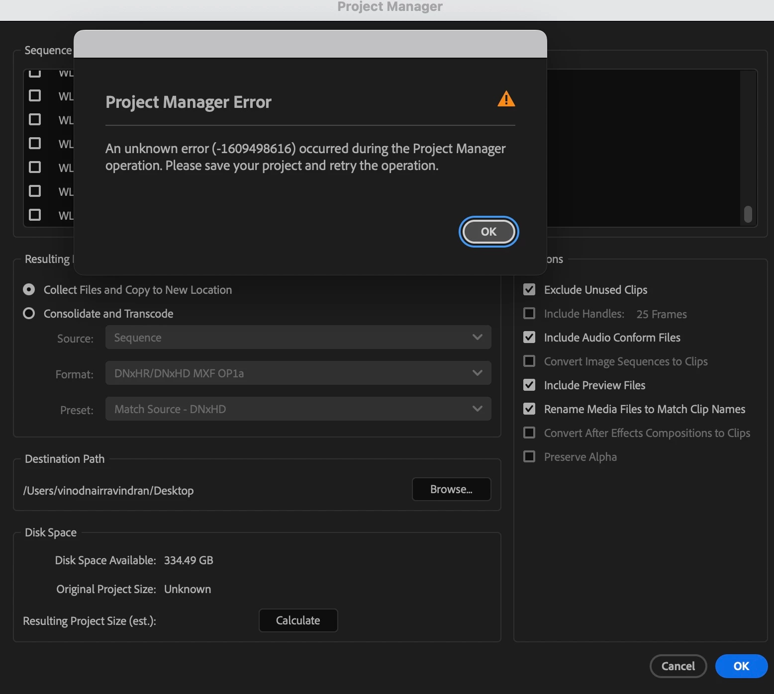

Project Manager Error 1609498616
while trying to save the entire project... or even just ONE SINGLE SEQUENCE... I'm getting this Project Manager Error 1609498616 (screenshot enclosed) for Adobe PP 2025 version 25.1
It doesn't elaborate on the error... as absolutely no clue how to resolve this and try to save the project.
It is frustating to go thru this, while I'm paying monthly subscription and still getting into issues for a simple task of saving a project.
Pls help, if anyone has this issue resolved?

I don't think you're going to like this answer, as it does not actually answer your question. The Project Manager is terribly unreliable depending on the formats you've used in your timeline. It often churns and never actually finishes, and sometimes it will present some kind of error. I don't know what your original timeline formats were, but that would be my guess - it's a difficult or unsupported format for the Project Panager to execute.
PlumePack is a very good third party tool to supplement the Project Manager (Mangler).

I again tried a work around for this issue, THIS MORNING,  as I cannot rest till I get this sorted.
And I FOUND A WORK AROUND (it's worked earlier too, so kinda flashed my mind, in my sleep 🙂
- CREATED another project
- Dragged and dropped few sequence I WANTED TO SAVE.... from OLD project to the NEW project
- Tried again to SAVE THE NEW PROJECT - and Voila... it WORKED
NOTE:
It doesn't always work... as just after few minutes... when I tried again to save IN THE NEW PROJECT... the same error message came once again even in the NEW PROJECT too... So it's ur LUCK, you get it working sometimes.
I had used different TEXT TEMPLATES... which I had also CUT abruptly few places (so it doesn't go out of screen towards the end of the template).... I'm assuming PP doesn't like to meddle around doing such ABRUPT CUTS... so perhaps that's why it was showing these error... not sure !!
