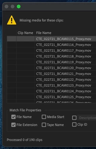

I have never used proxies in my workflow because my system can easily handle 4K.  I had time to experiment on a big project with a generous deadline.  Turning proxies "on" for ingest actually created more work for my system.  So I detached the proxies and now they won’t go away.
  1. Detached all proxies - NG
  2. Moved all proxies to a new folder - NG
  3. Imported sequences to a new project - NG
  4. Selected Ignore all on project opening crashes the app
I know how this story ends - I will end up trashing all of my preferences and doing a clean install.  If anyone has an easier way to solve this problem, please let me know.

It seems like the simple answer to my question about proxy files having a life of their own is that the proxy workflow is a background operation.  You can choose not to view them or use them, but they will always be associated with whatever clips were ingested with the proxies turned on.  Sequences that use clips that have proxies are forever associated with those proxies.  I've deleted media cache, cache database, reinstalled apps and imported sequences into pristine projects and still the proxy relationship exists.  I can watch the software generate .pek files for the proxies in the background.  The "detach proxies" function looks as if it works, but it doesn't and if I offline the proxies upon opening a project, the app will hang.

The problem is that I now cannot work with the project when the proxies are offline.  I'm stuck with 200GB of proxy files that I don't need or use.

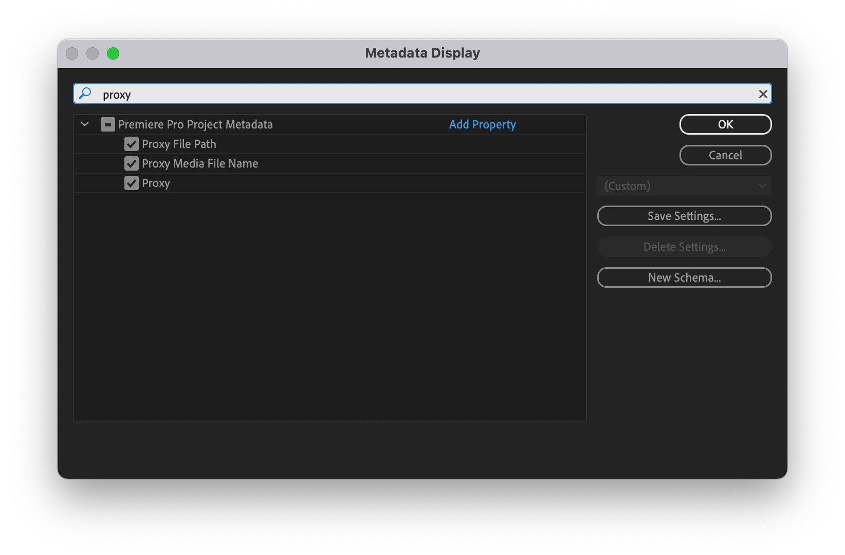

What exactly do you mean 'they won't go away'? You are still seeing the proxy version? Even if you've moved the files?
Have you enabled the proxy columns in the metadata display? Does the proxy path not disappear when you 'detach'. It does for me (just tested a couple of clips in v15.2).

They won't go away as in the subject of my post "proxy files do not detach."
Mike Dziennik
May 12, 2021
Just close your eyes then. That will make them go away.
But seriously, you have to explain exactly what is happening. Have you enabled the columns as I've described? Help us so we can help you.
