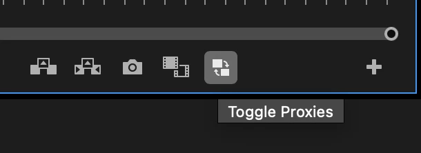

When the proxy icon link appears broken, it typically means that proxies are disabled, not unlinked.
To re-enable proxies, click the Toggle Proxies button in the Program Monitor. If the button isn’t visible, you can add it by clicking the "+" button (Button Editor) in the Program Monitor and dragging the Toggle Proxies button to the toolbar.
