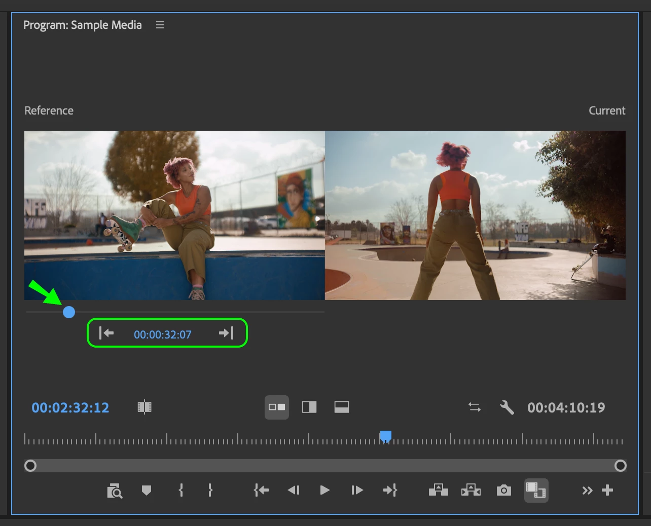

    ​@warr_0376 When Ii move the button you highlighted green, the Reference monitor remains black and the timecode doesn’t change (it stays at 00:00:00:00)

    When I use the control you point to with the green arrow, nothing happens. the Reference monitor stays black and the timecode stays at 00:00:00:00. I’m on PP 2026.4.1

    Use the transport controls that appear directly below the Reference picture.  There’s a slider handle, previous edit button, timecode text field (click and drag or click and enter a value), and next edit button.

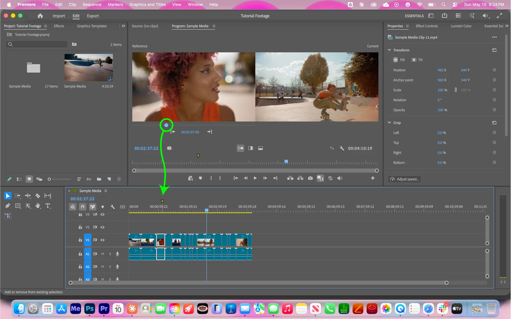

    Maybe this screen shot will help.
    The Playhead is showing the current time 0:02:37:22 while the Reference is showing 0:01:07:20.  I placed a Timeline Marker at 0:01:07:20 to show where that is in the Timeline and selected the Clip Boundary in Video Track 1 at that time as well.
