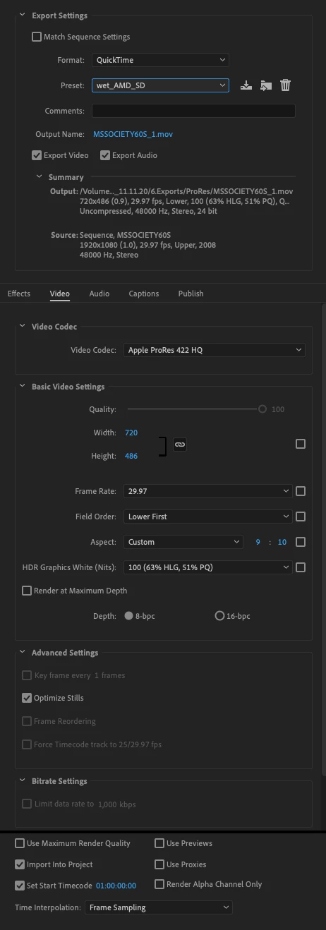

When I check the exported movies in Premiere, QT Player or Sony Catalyst, they are all showing 29.97, so I was confident I was sending the correct file. I am attaching my AME Encpoding settings.

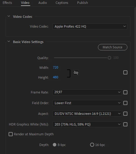

Averdahl
January 28, 2021
Try to un-check Optimize Stills.
Any reason behind the odd resolution combined with a Pixel Aspect Ratio for 4:3 (0.9) instead of 16:9? Why not 720x480 with a PAR of 1.2121?
rlavonAuthor
January 28, 2021
Hi-
That is not the screen shot I attached. Mine had an aspect ratio of 9:10 and a screen size of 720x486
Averdahl
January 28, 2021
Correct, the screen shot was added by me and that´s the dimensions/pixel aspect ratio that SD footage has.
(Still wondering why you use non-standard settings...)
