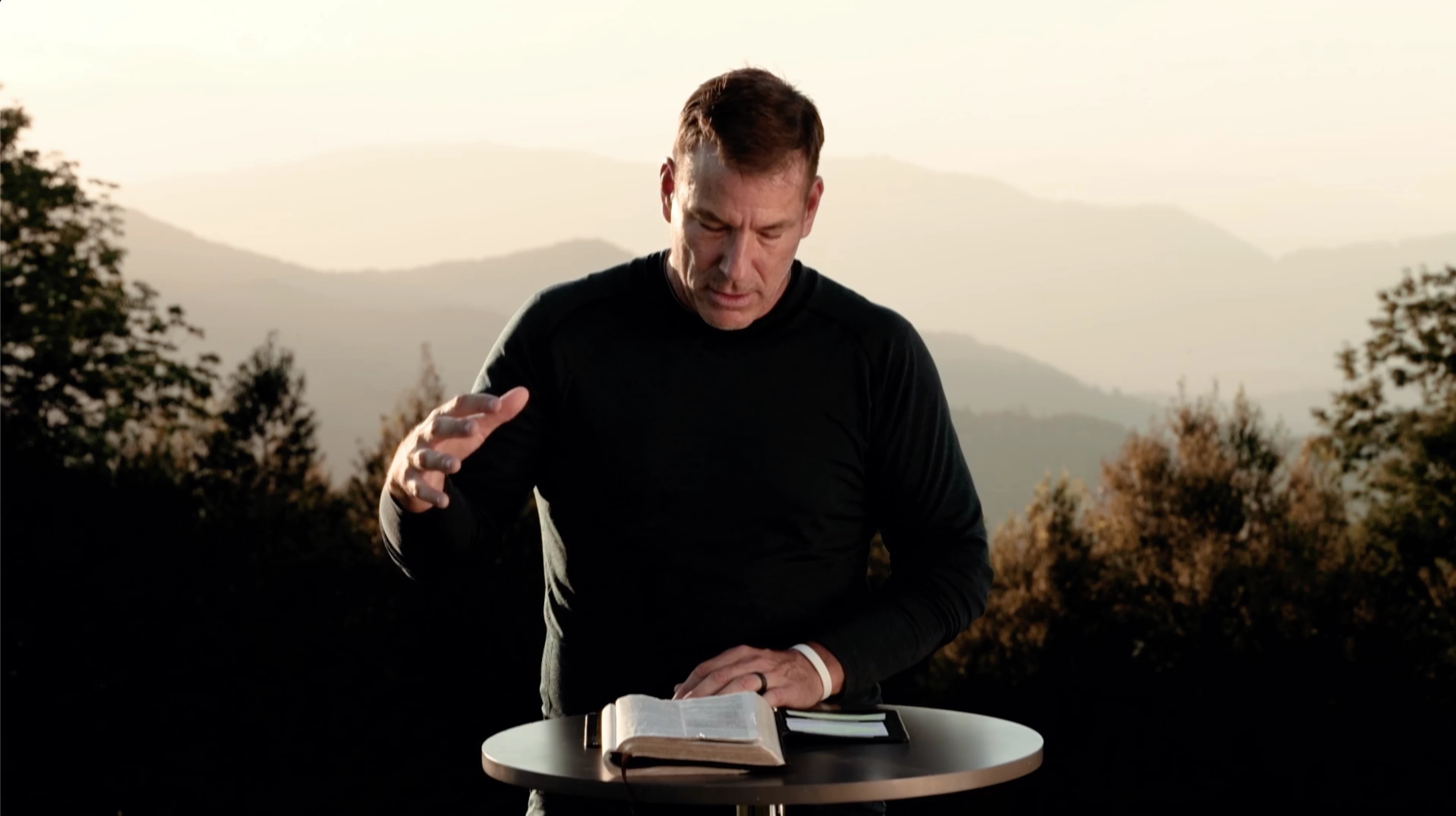

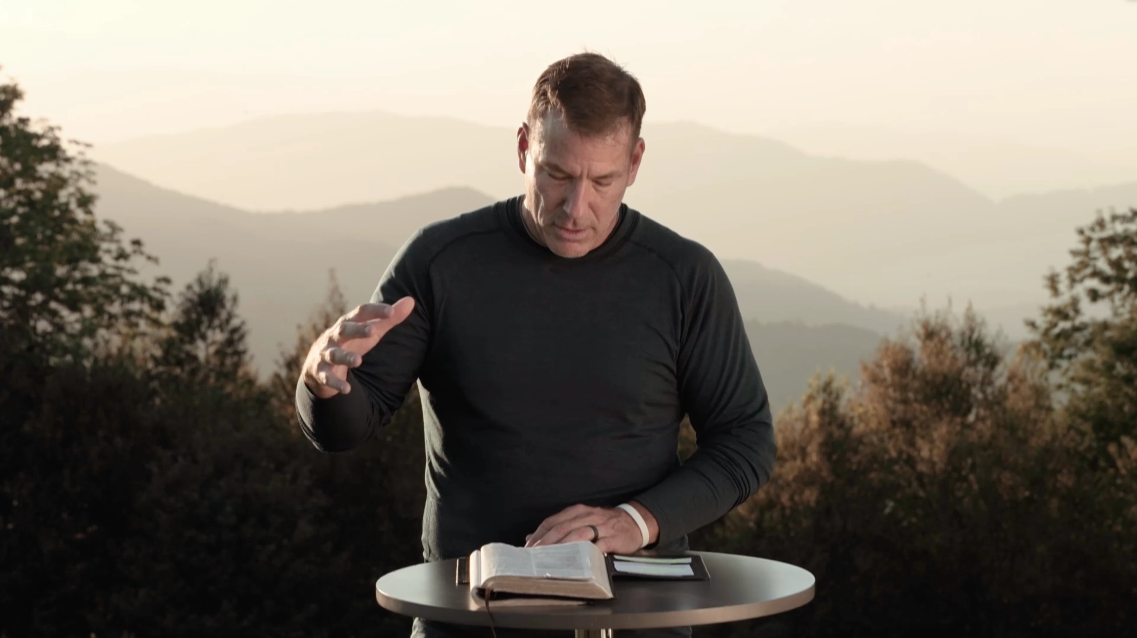

We are having an issue. No LUTs are being used, just Lumetri Color adjustment. The saturation and contrast are really high when exporting through Media Encoder. But when exporting straight from Premiere the issues does not seem to be happening. We are exporting H264 but the issue still happens when using ProRes and Quicktime codecs
Attached are two pictures for reference

Thanks for your steps and explanation but unfortunately the above changes did not effect the outcome of the footage. I have been able to recreate the problem in Premiere by checking the box “enable hardware accelerated encoding” when this box is checked in Premiere everything in the timeline looks as how the exported file is looking coming out of Media Encoder, saturated and contrasty. I thought maybe if I unchecked the media encoder it would solve the issue but regardless of if the box was checked or not in Media Encoder it still exported over saturated and high contrast.

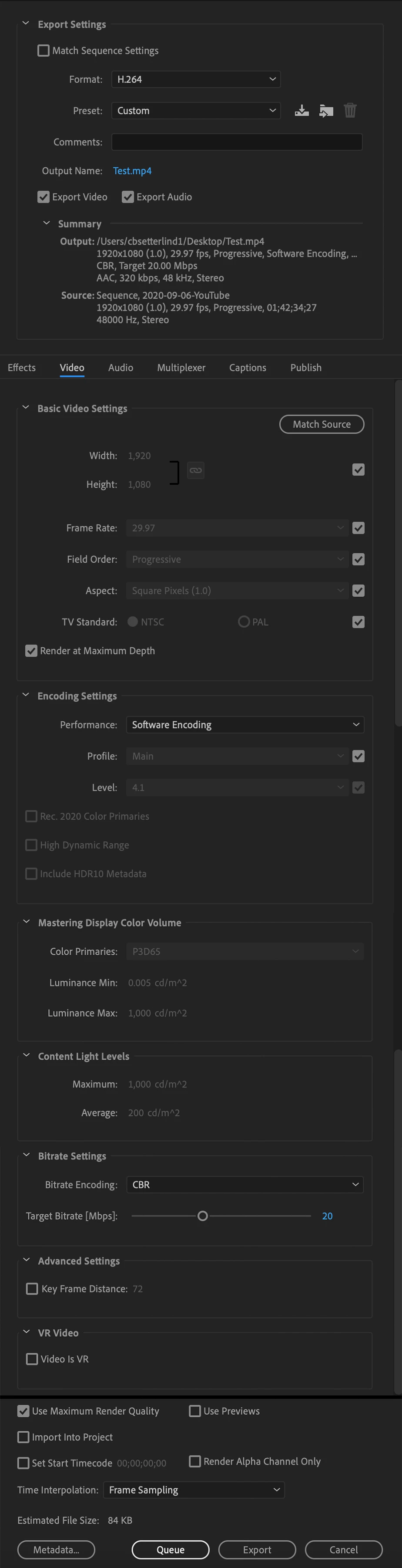

September 8, 2020
Really weird ... it would be good to see a screen-grab of the Export dialog box, both the full right-side and also the Effects tab of the box shown.
Neil
Everyone's mileage always varies ...
cbsett60Author
September 9, 2020
Absolutely. Are the attached images helpful?
The weird thing is exporting through Premiere everything seems to be fine. But when we queue through Media Encoder The color is way off. (We had the opposite problem in a previous version but switching to hardware encoding fixed the issue. This time it is not the case.)
