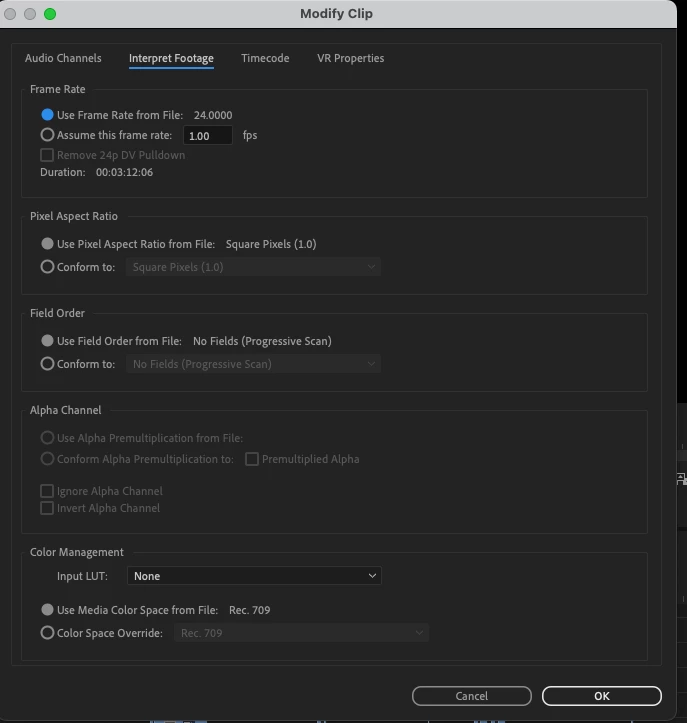

The DOP says that he shot the footage In LOG, but after I imported the footage in Adobe, and I go to properties, it shows that the Color Space is REC 709. Also, when i go to Interpret Footage, down below, it says Color Space from Source file: Rec 709. I don't think I'm seeing my imported footage in LOG, even if I override with S-Log 3 Gamut.

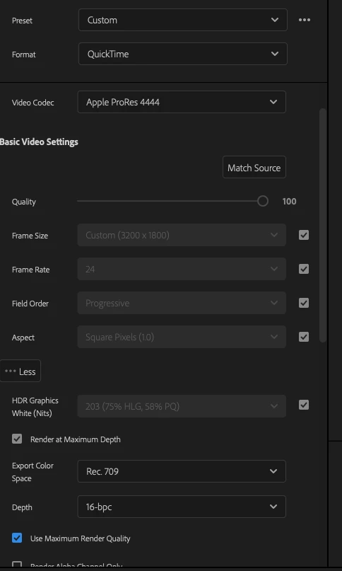

It's not be an issue how I see it, but I might need to do an export for the Grade, like an Apple Prores 4444, and I want to send it correctly, like in LOG. I have the feeling when i export, the color space is overrided with LOG.

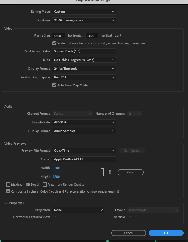

Just one more question, please. if you don't mind me asking. Is there a setting that I need to take into consideration if I have to export a short film in something like Apple Proress 4444 for a grader or post house, instead of sending the source footage? I know I need to disable any LUT, but I want to make sure I export a correct version, like the DOP shot the footage in LOG-C, without any conversionts or color space overrides that Adobe Premiere might put. I've attached screenshots with my Sequence Settings, Interpret Footage and how I think I should export. Maybe everything is fine, but just want to make sure I got everything right.

If you deselect the "auto tonemap" option, you may get the log-encoded media 'straight'. Looking log-ish.
I would test that process immediately with any prospective colorist. Put a clip on a sequence with auto tonemap enabled, export the ProRes444, and then do another with the tonemap off. If that does look more 'log', try an export of that to the same settings.
