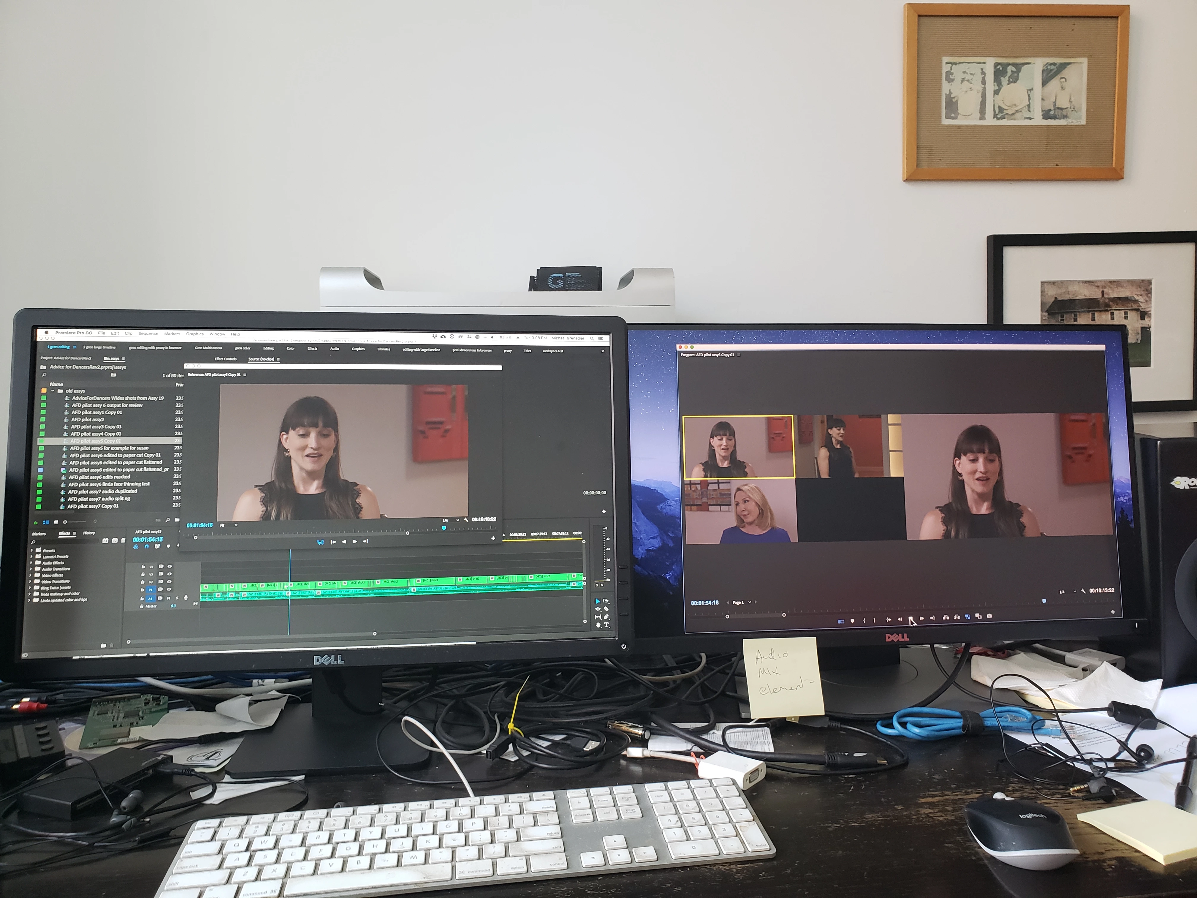

Take a look at this photo.  Is that what you're trying to do?   cause it works fine on my system working with proxies.   I'm pretty sure the source material was h264 (shot on canon cameras) 1080 24p.  And the proxies were with the same pixel dimensions prores proxy.

Using your picture as reference, in right monitor I have "program window" as you, but without program video, only multicam. In the left monitor I have "reference window" with option "gang to program" to follow multicam playout (and other windows like timeline and project).
In my case, "reference window" is a "final program video" to maintain cameras alone in just one monitor.
Try to select the "gang to program" on "reference monitor" using that configuration an let me know if you see something anormal in "reference windows" during continuos playout.

I guess I don't understand why you're working this way.   What are you seeing that you wouldn't be seeing in the way I described that you say works fine...?   (man that's a confusing sentence, hopefully you can figure it out).
January 21, 2020
you might find using a proxy workflow more dependable particularly with a multicamera timeline.  You don't tell us what format your source video is (codec, frame rate, pixel dimensions).  I'm not sure exactly how you are setting up your workspace.  I have a blackmagic intensity pro card in my mac pro and I have that feeding my program to a second monitor.  the main monitor I have a workspace set up for multicamera work with the program monitor which includes the multicamera view (if that's the right term) expanded to the left as far as it will go since I don't really need the source monitor while doing my "switch."  I have a different workspace I can quickly switch to if I need to edit from other sources or adjust effects.
