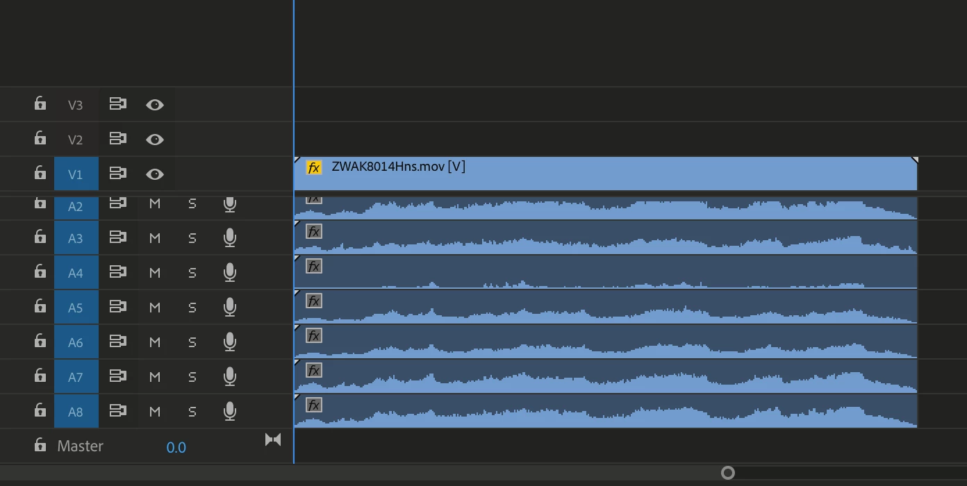

I help run a small local cinema where we show short films and promos, but I often have to adjust the video to make it work with our projection system.  The problem occurs when I'm sent a ProRes mov file with pre-mixed 8-channel sound.  I have to modify the video, but I want to retain the audio as it was delivered (or as close as possible).  However, when I drop the file into premiere, it unmaps the channels.
When I drop the file into my timeline, this is the sequence it creates:
I've tried creating a new sequence with 8 mono tracks, multichannel tracks (with panning done in the mixer), etc., but nothing quite works.  I usually end up loosing the rear surrounds.

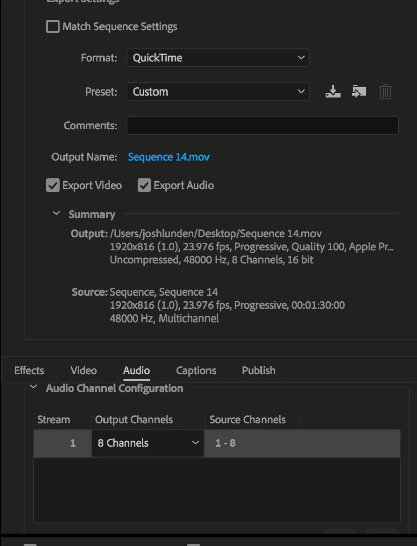

    Hi Richard,
    I can do that, but I think the issue comes in when I export.  If I'm exporting to ProRes with uncompressed audio, how does it know to map the channels to the correct speaker locations correctly if I'm only panning left and right in the mixer?  This is normally how I'd export.  What do you think?
    Trevor_AsqCorrect answer
    Apr 21, 2018 1:04 AM UTC
    You have to click on the ‘output assignments’ in Richards screen grab above, or the same little icon in the track mixer, and route 3&4->3&4 etc. Default is for them all to route to A1&2
