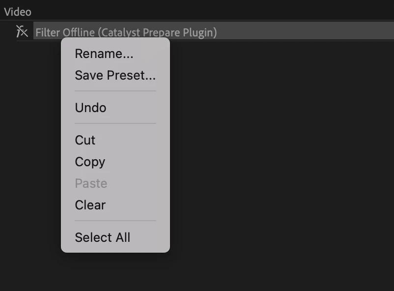

I hope this will be my last post about this horrible Sony Plugin and the nightmare will end soon..
I need to delete the Sony Plugin effect from all of my clips, but cannot remove the effect in the effects panel.
Right-Click and selcting "clear" has no effect.
I copied all clips to a new project but the effect moves with them.
After I deleted the plugin, the effect is offline but still there.
How can I ever get rid of it?

The effect that you are seeing is the source settings generated by the importer plugin. You cannot delete it as long as that importer plugin is being used to read the files. You should uninstall the plugin and ignore the missing filter warnings. With the plugin gone, the settings are irrelevant and will not be an export problem.

I am afraid it DOES affect export. I wasnt able to export my timeline with the XDCAM plugin because it sends the timeline to AME in the background. I deleted the project, edited a new project and exported with exactly the same settings. No problems at all. So if you import with the activated plugin you WILL have problems later on.. even if you delete it.

I got your message. I think I understand your situation. Try Edit > Remove Attributes and enable the Sony plug-in. Does that work for you? Let us know. Sorry for the hassle.

Hi Kevin, thanks for your help. Unfortunately Remove Attributes is not available for Clips in the browser window so its greyed out. For clips in the Timeline I can select "remove attributes" but the Sony Effect is not available as it can only be altered for clips in the source browser. Any other solution? This plugin an totally destroy any production, you will notice most problems only later on in the process.
