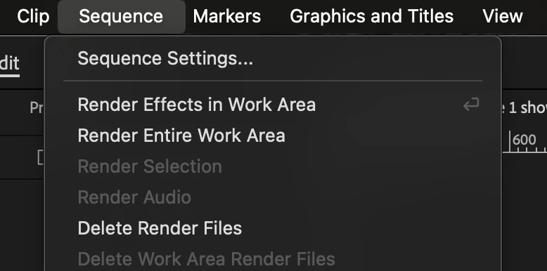

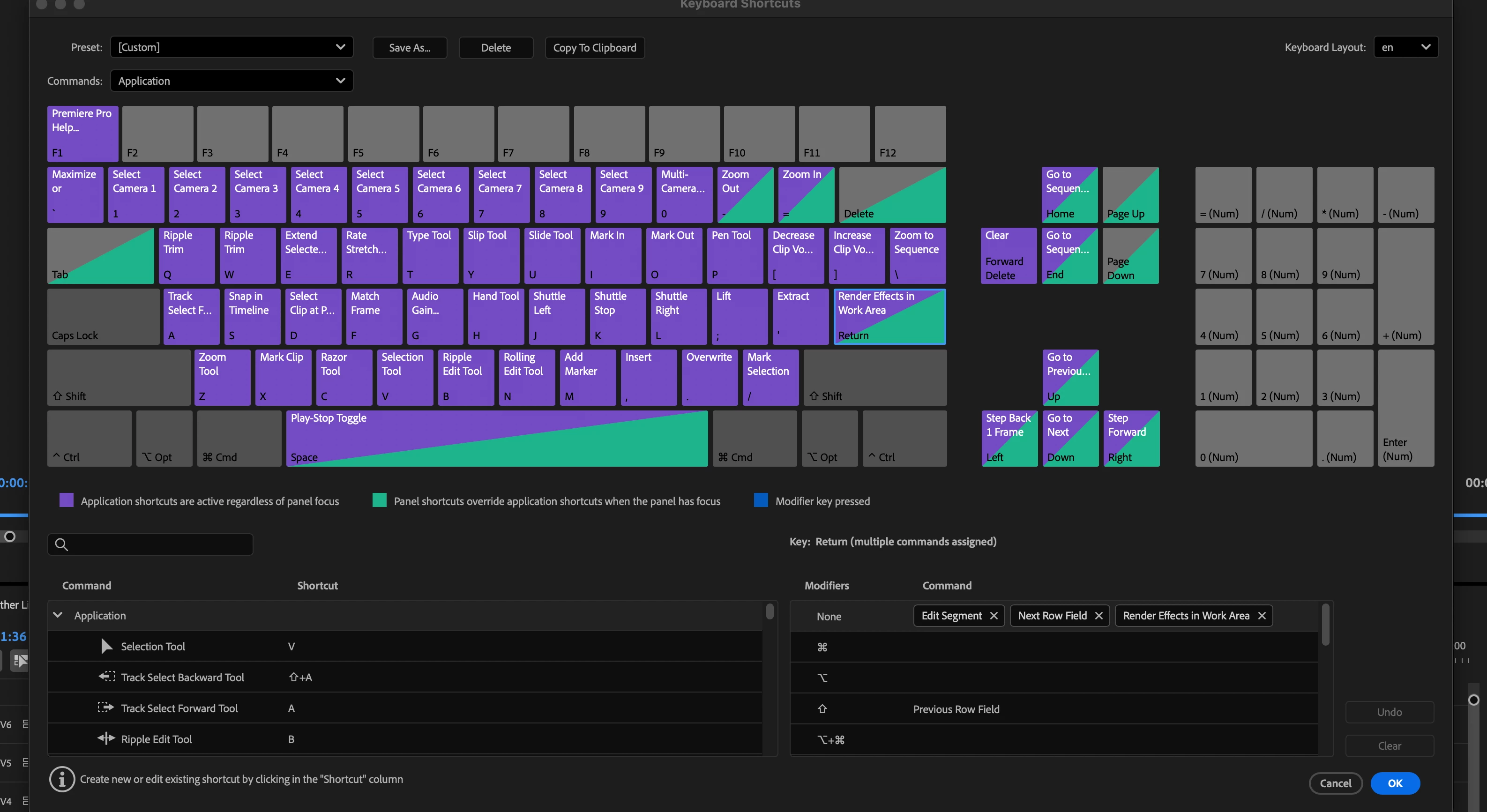

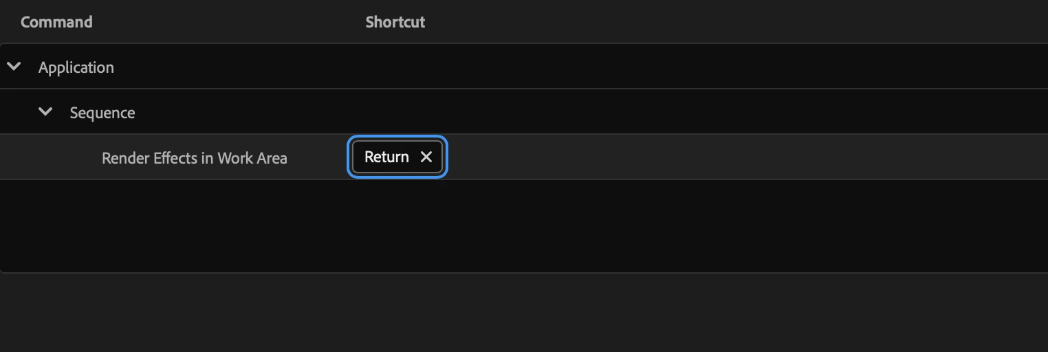

spinachworld
Oct 13, 2025 10:39 PM UTC
See screenshots.  The Return key icon shows on the top menu as a shortcut for rendering, and it was already assigned on the Keyboard Shortcuts.  I tried removing and reassigning it, but it still doesn't work for me.  Also, going to the top menu and clicking "Render Effects in Work Area" also does nothing.  "Render Entire Work Area" is the only thing that responds.
I cleared cache and I was able to export H.264 using the High Quality 1080p setting, but still got the freeze on the Match Source.  I tried exporting with Software Encoding and it was actually worse than with the Hardware setting.
The transitions are from the Effects menu, not third party, and they're just basic wipes and dissolves.
