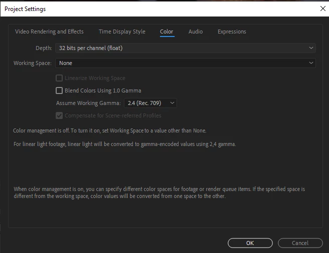

What are you color management settings in AE?
And again, is Composite in Linear Color checked in either place? That is often a problem child.

I'm wondering if you have a color management mismatch between Premiere and AfterEffects.
I would also uncheck "composite in Linear color" in the Sequence settings and see if the banding goes away. You may need to uncheck that, then Render/Replace again.
I'd test that first.
