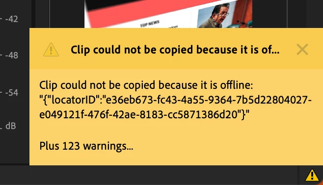

Hi, I'm trying to use the "Render and Replace" feature for the first time but I keep getting an "offline" message for, what it looks to be, every single clip in the sequence. The clips are online.
I open "Render and Replace" and select my "Source," "Format," "Preset," and destination. Then I click on "OK" and it gives me this yellow popup message at the bottom right side of the screen - I'm attaching it.
I tried different settings and even one single clip, but I got the same error. I also tried it on another computer with a different CC account.
Any ideas?
Thank you so much,
Correct answer martinc1656642
Ok, it looks like it's a Team Project issue.
Converting the "Team Project" to "Project" fixed the issue. I have to convert the "Project" back to a "Team Project" after the process so it's not ideal but will work for now.

R Neil Haugen
January 3, 2024
What is the exact location of those clips? The specific folder tree address? How are they "mounted" I think is the Mac term?
Everyone's mileage always varies ...
January 4, 2024
@R Neil Haugen Thanks for your quick response.
The clips are located in an external RAID. I tried on a different computer with an external SSD but had the same issue.
After reading your question, I copied one of the clips to my desktop, re-linked it but I get the same message.
I'm working on a Team Project, I wonder if that has anything to do with it.
martinc1656642AuthorCorrect answer
January 4, 2024
