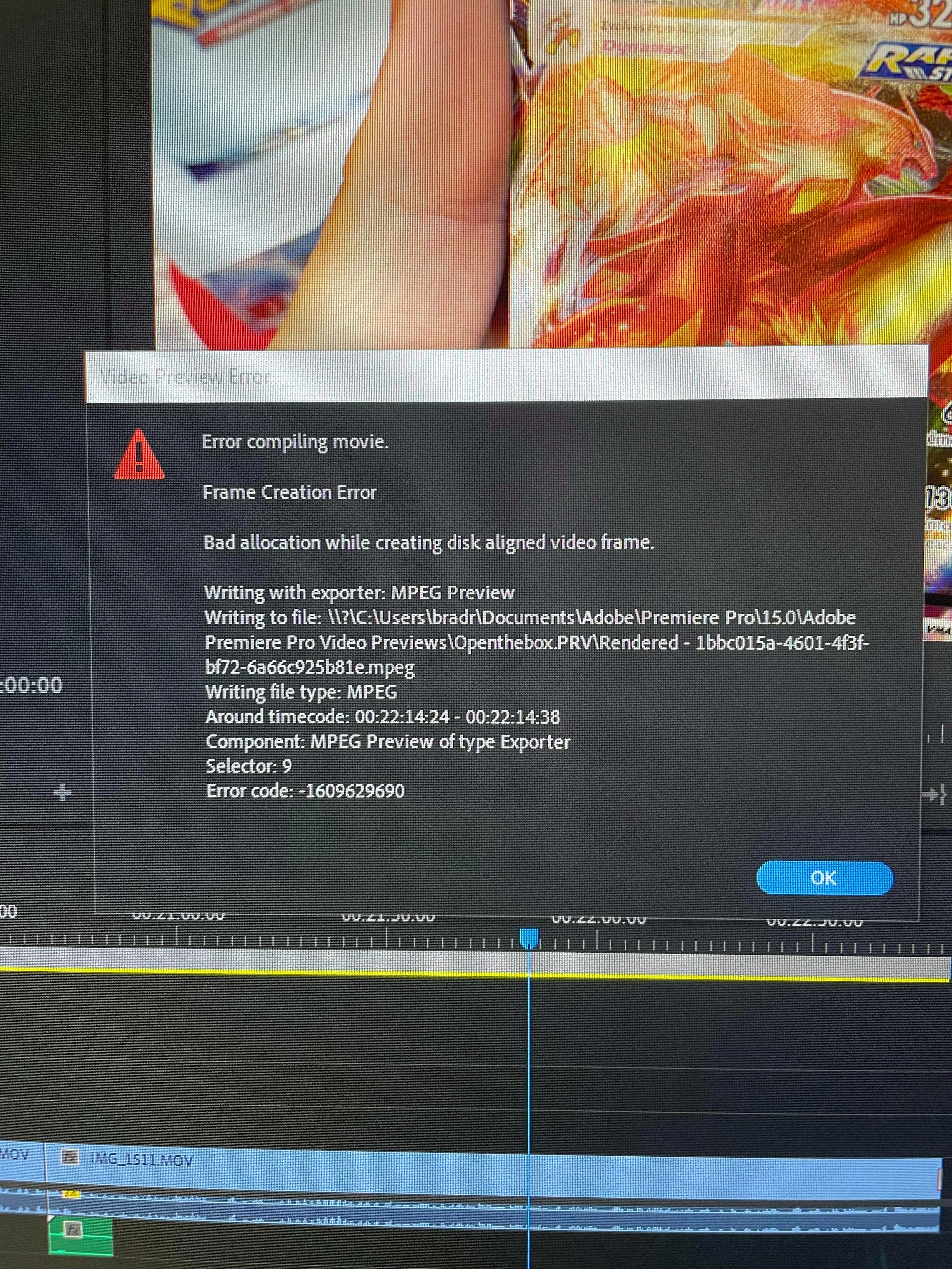

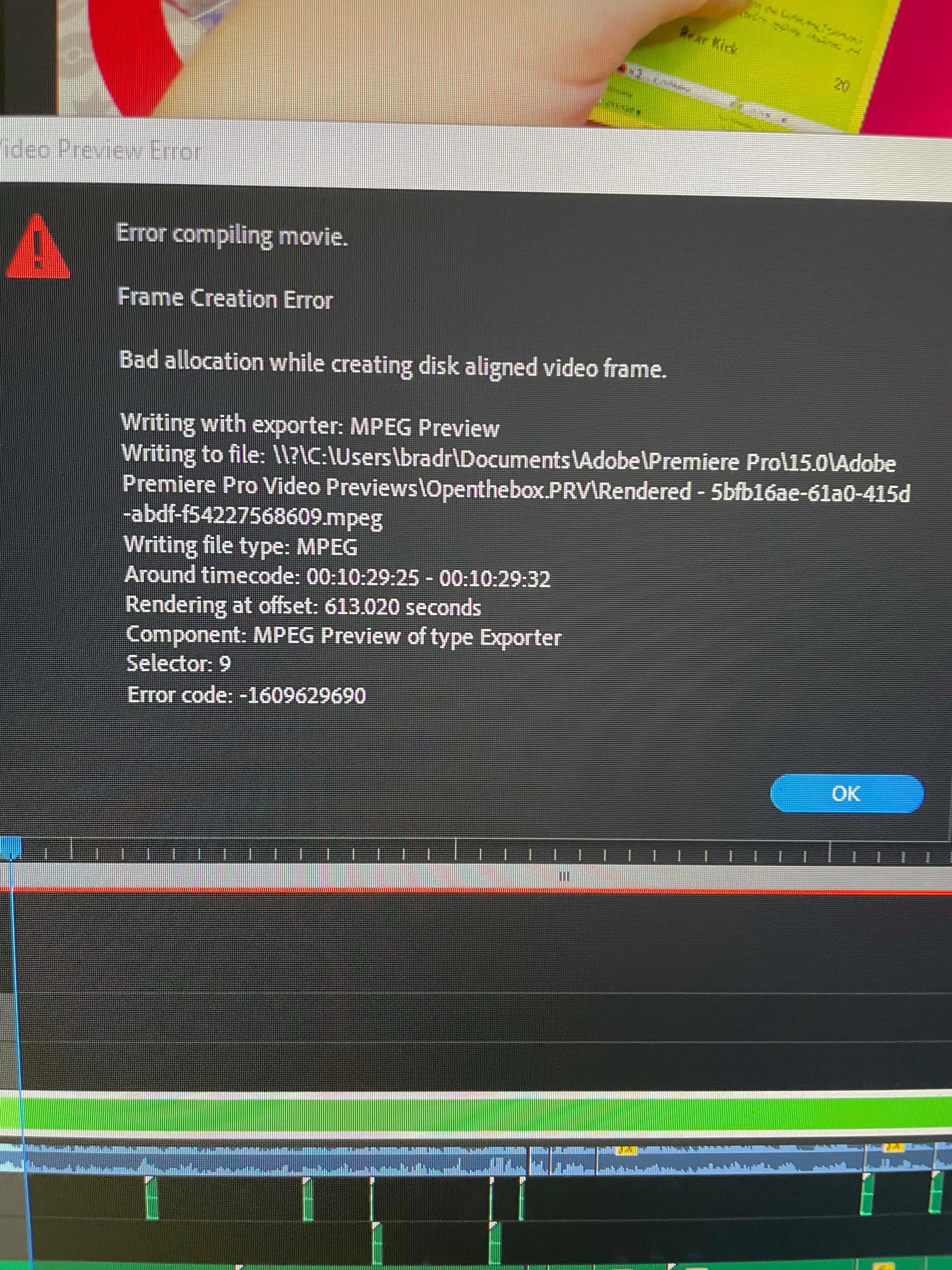

I have suddenly not been able to render or export any videos as of a couple days ago. I cant render the time line without many errors coming up so i removed the problem frames and any effects in it and tried again. same errors. then it was low memory so i cleaned out half my terrabyte drive for space and used cc cleaner and the adobe built in cashe remover and then it was another error withing the exporting where my computer went silent and stopped rendering around half way. i have tried to un insatll and reinstall, i have tried older versions, i have tried restarting everytime i try to render or export. i have tried to render out of the encoder program. crashed half way many times. i have tried with render only software options, exoprt without hard ware using software. I have tried just rendering a completly different 20 min video and it has same problem when it has no editing done to it, just the plain video. I have tried to just export many times and everytime the error time is different. two times I managed to render 11 mins out of 22 and the video was cut short after that 11 min mark cause my comp crashed but i was able3 to view the video after i restarted.
"bad allocation while creating disk aligned video frame" is the most common if it doesnt crash. I have also been hit with low memory error. I am so dissapointed with this, this is the last thing i can try. Like i said, ive had this working smooth no issues for 6 months now and last edit it just broke?

there is only my video on the time it fails. no editing. and it fails on random times. the fail isnt on one thing everytime is alwasy different. i posted pictures.
