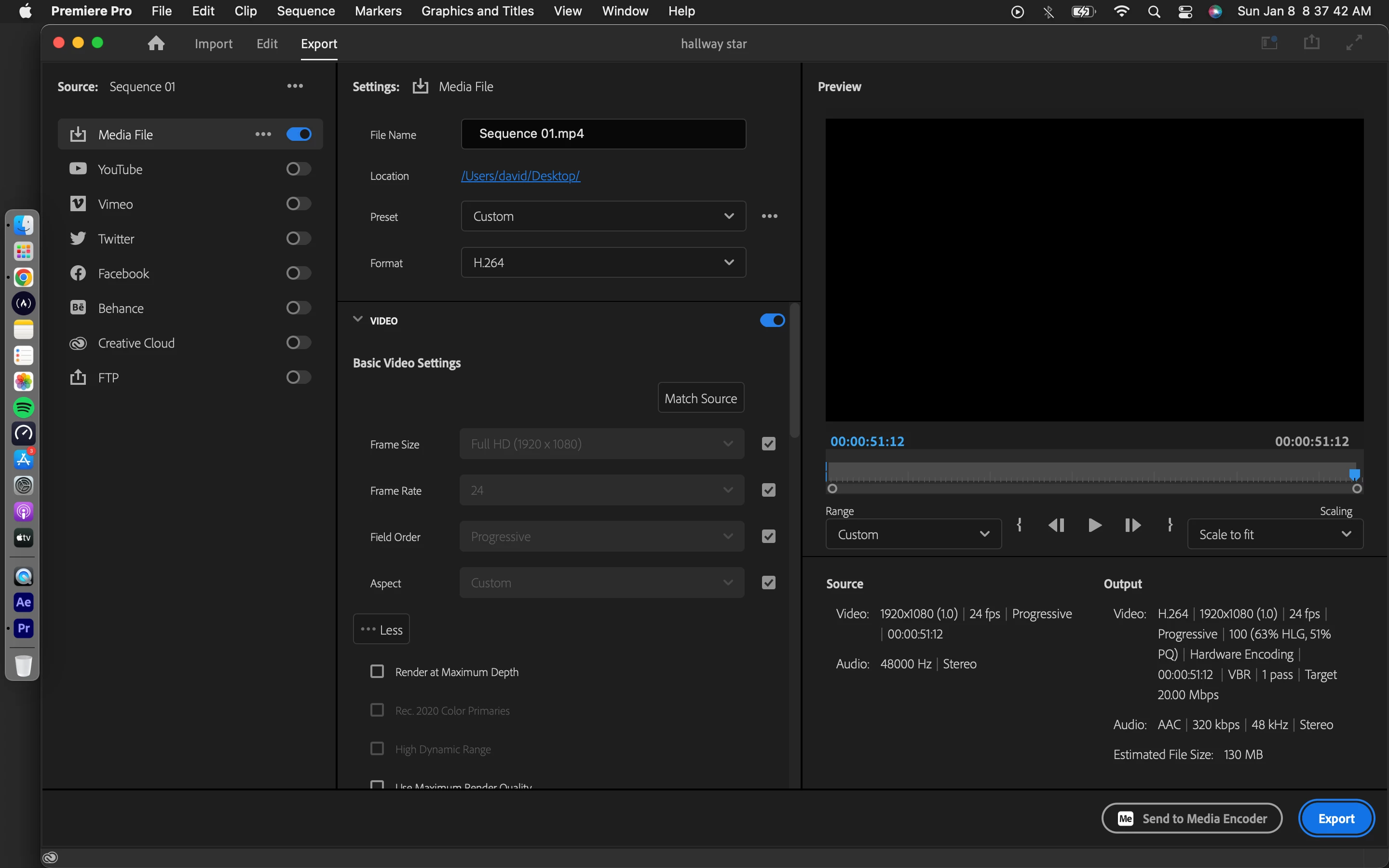

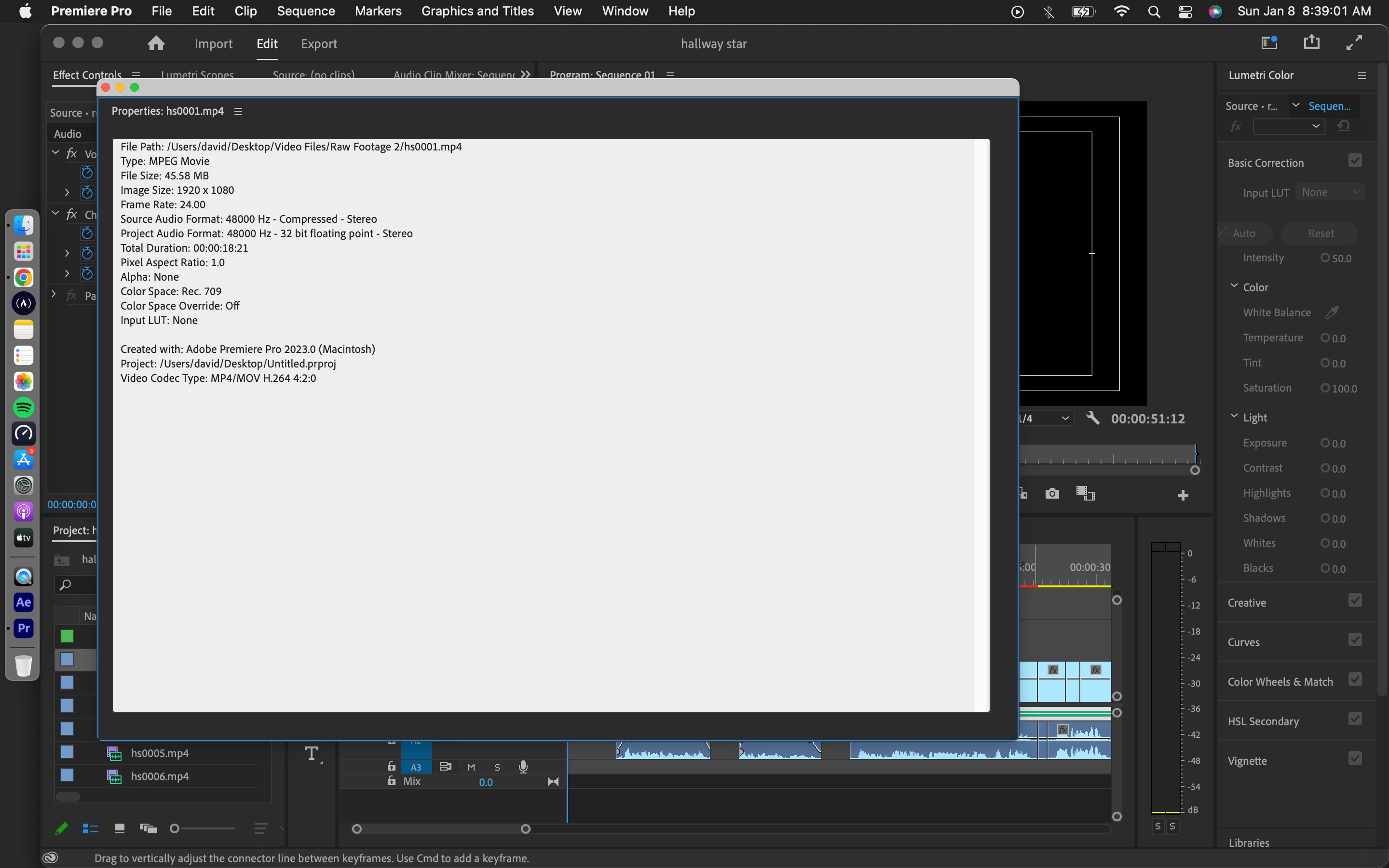

Sheehan72
Sheehan72Author
January 8, 2023
Thank you so much for trying to help! Here are some screen shots.
