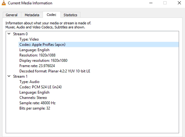

I have recently run into this problem when I export a sequence where my audio render times (separate from the ACTUAL render) takes hours.  Even on a small 5 minute video, it takes approx. 1 hour.  My Windows-based PC is more than competent and has all drivers updated.   I am using the latest version of Premiere and have not changed my workflow in anyway.
I've looked on other forums and tried everything but to no avail (unchecking Generate Peak file, cleaning out cache, unchecking Match Sequence settings in the export menu, starting a new project, etc).
The only thing I have noticed with the project is that my audio files are 24 bit and the sequence is 32.  Not sure how much this affects the export but I don't think it would; it hasn't in the past.  I have attached a photo for what I am experiencing.

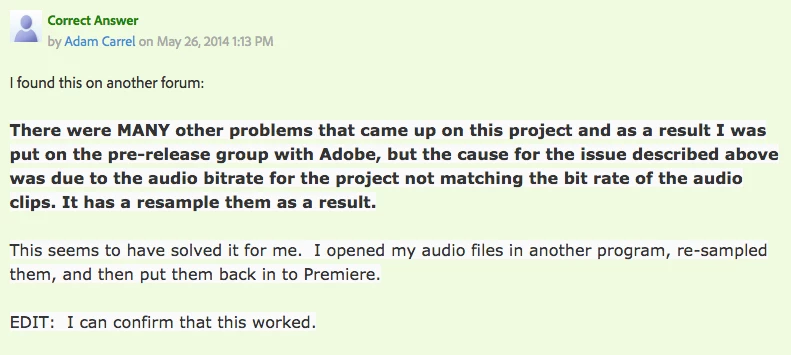

I found this answer on another forum after looking for solutions to my own problem.
Sure enough, I have two different bit rates of audio in my timeline and resampling fixed it. Not sure if in my case it's the two bit rates or (one of) them not matching the sequence...

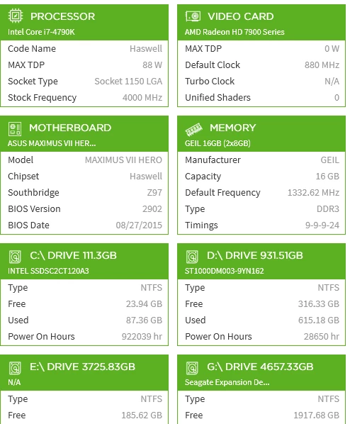

It does help a ton to get actual hard data to start puzzling through a trouble shoot ... OS/CPU/RAM/GPU/vRAM, the number-dot-number version of PrPro (as so often it says it's up to date when it isn't), the number & type of drives used, the media used, how it was created (camera, device, screen-capture, what?), any effects used, any plug-ins or third-party apps involved.
Also ... from Task Manager, how many processes are running when you have PrPro open and are working?

There are the computer specs.  Using Premiere 2017 build 11.1.2 (22).
I am using a newer 5TB Seagate 7200rpm hdd to edit on (applications are stored on SSD)
This is the footage information.  Shot with Blackmagic Ursa Mini 4.6k.
