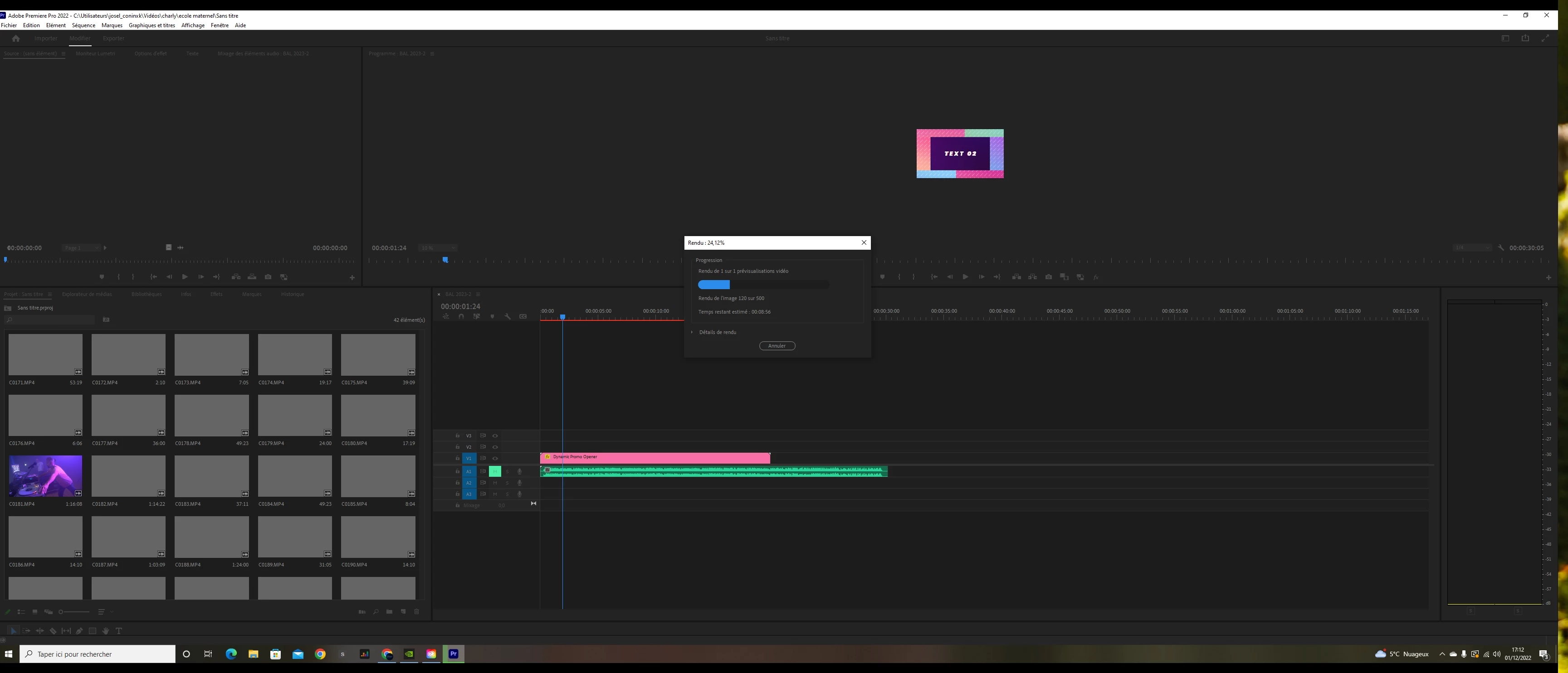

Bonjour,
Je cherche de l'aide car en faisant un rendu sur un fichier graphique animation titre etc pour 20 sec ça met 10 min... je vais pas attendre 10 min à chaque modification de texte etc... avez vous une solution si ça vous ai déja arriver ? j'avais également ce probleme sur mon mac M1.
merci d'avance 😃
December 1, 2022
When you're using Dynamic Link it's really going to depend on what the content is and how optimized that is over in After Effects. You're basically opening a background version of After Effects and are processing full frames of whatever is built over there, and that can be quite complex. You can have AE projects that take several minutes per frame to process. It could be using effects that are constrainted to the CPU or single-threaded, which could create a bit of a hardware bottleneck. But it's hard to be able to answer any more thoroughly than that without better understanding what this mogrt or dynamically linked comp is. They can be convenient, but aren't necessarily fast.
Edit: You added the link to the mogrt in your other post. Thank you. Probably depends on which title you are using but some of those may be using methods that can be a bit slow to process. You can also try opening these MOGRTs up in After Effects and rendering directly out of there to see if it goes any better.
December 1, 2022
C'est un effet qui s'ouvre sur adobe PP et qui peut ce modifier directement sur ce logiciel sans passé sur AE. Ce que je comprend pas c'est que avec des rush 4k le rendu est rapide mais des que il y a des annimations meme un simple titre c'est extrêmement long ...

December 1, 2022
I am guessing this takes a long time because multiple clips are used at the same time (and in UDH?).
How many clips are involved.
Lots of pixels to render.
Get Premiere working properly first.
All your thumbnails have not loaded yet.
Just to be on the save side roll back your gpu driver to 517.40 Studio driver.
Peru Bob
December 1, 2022
What effects are applied to it?
December 1, 2022
c'est un effet télécharger sur ENVATO ELEMENTS https://elements.envato.com/fr/dynamic-promo-opener-5HHMENH
