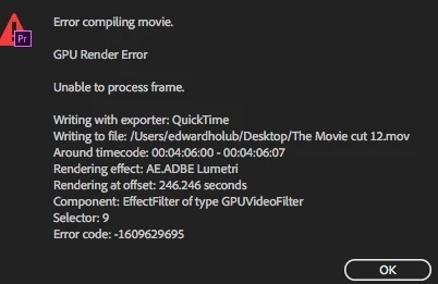

    Dear Adobe,
    I am also getting the following error message:  PLEASE EMAIL ME BACK . [personal info deleted]
    Error Compiling movie.
    gpu render error
    unable to process frame.
    writing with Quicktime
    rendering effect: AE.ADBE Lumetri
    Component: Effect filter of type GPUVideoFilter
    Selection:9
    error code: -160962695
    January 6, 2018
    Trying turning off GPU acceleration (change to Software Only). Also given my past experience you'll be waiting for Adobe to help forever.
    December 31, 2017
    Dear Adobe,
    I am also getting the following error message:  PLEASE EMAIL ME BACK . [personal info deleted by mod]
    gpu render error
    Selection:9

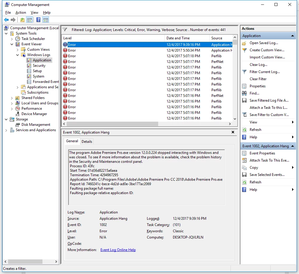

    Here is a screenshot of an event error log from one of the recent crashes. None of this means much to me but here it is in case it helps.
