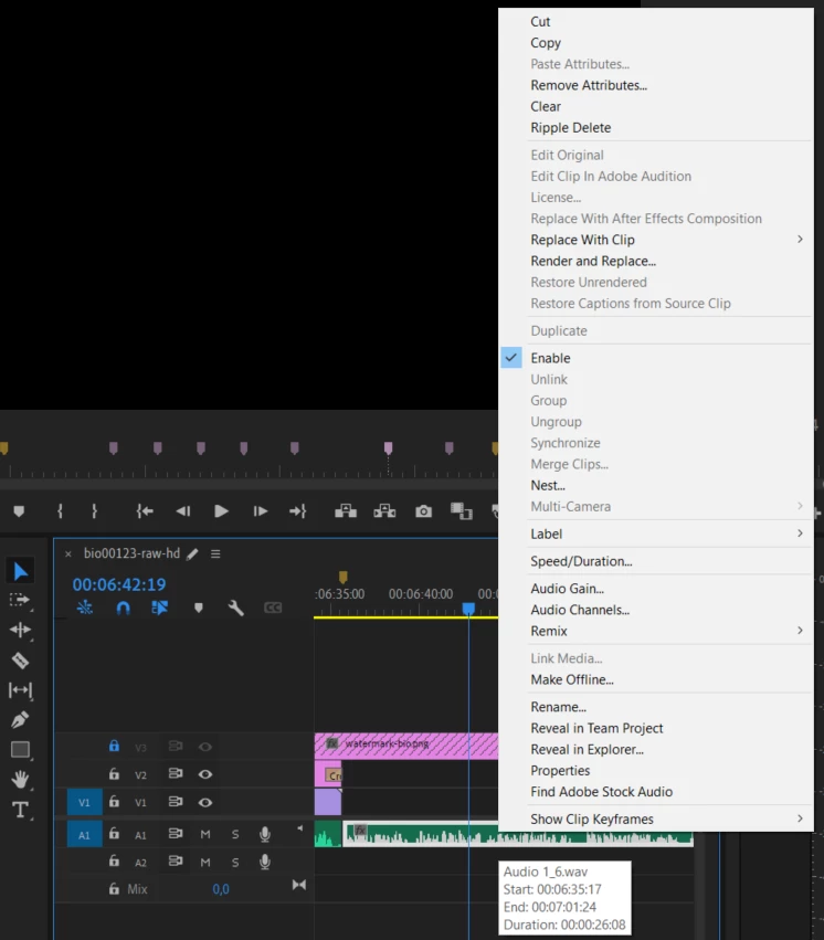

Hi All,
I am doing a project in Premiere Pro CC but need to dynamic link to After Effects CC.  The "replace with After Effects Composition" button is greyed out and I can't understand why, both are installed!
I still have Premiere Pro CS6 and AE CS6 installed, because they contain plug-ins I use regularly, could this be causing an issue? I can't think why it would.
Any help would be greatly appreciated.

I'm using AE17.6.0 and PP14.8.0 and they don't work.
I can use the dynamic lick option in my AE(in the File menu) which opens a project in Premiere Pro.
But I can't use the 'replace with after effect composition' and 'Adobe dynamic link(in the File menu)' which are in Premiere Pro, they're greyed out. Please help me out.

Hi, I don't know if that's your case, but I discovered that you can't use Replace with After Effects composition unless you have some visual media - it doesn't work when you have audio only in Premiere Pro. But if  you add something, e.g. a simple rectangle, suddenly this option is available. It's not very convenient and creates unnecessary compositions within AE project, but it works.

I got help from Adobe to get it fixed. If you use the latest versions of PP and AE from Creative Cloud you just need to install the previous versions:
PP 14.0.4 and AE 17.0.5. These versions work together.

Hey i had the same problem and i found something that works for me.
The icons havent updated yet so i opened Premier pro 2018 instead of 2019, when i opened the project in 2019 and tried to use dynamic link it worked.
Im using it on mac tho.
And i uninstalled AE 2018 as well.
February 1, 2019
This fixed it for me.  I had updated my Premiere pro to CC 2019 but my After Effects version was still CC 2018.  As soon as I update AE I was able to use Dynamic Link and "Replace with After Effects Composition" was no longer greyed out.

I haven't seen anyone mention anything about trying to "dynamic link" from After Effects to pull the composition.
I had the "Replace....." greyed out also, but as one of the staff, Vinay D. suggested--
"Are you able to launch premiere pro cc from after effects, please try and check what happens when you go to after effects file menu>dynamic link."
I tried that ^ and it worked. Maybe the advice got buried too quickly to be seen. Anyway, I came here with the same issue and it got resolved. Thanks Vinay Dwivedl.....

I am also having the exact same issue with same exact screen shot as above mac.  i only have cc2018 installed of photoshop, premiere and after effects.  iMac 2017 4.2Ghz Intel Core i7 - Ram: 32 GB 2400 MHz DDR4 / Graphics Card: Radeon Pro 580 8192 MB.  When I select the clip to go out to photoshop or after effects all of those options are greyed out. (Exact same screen as above user)
