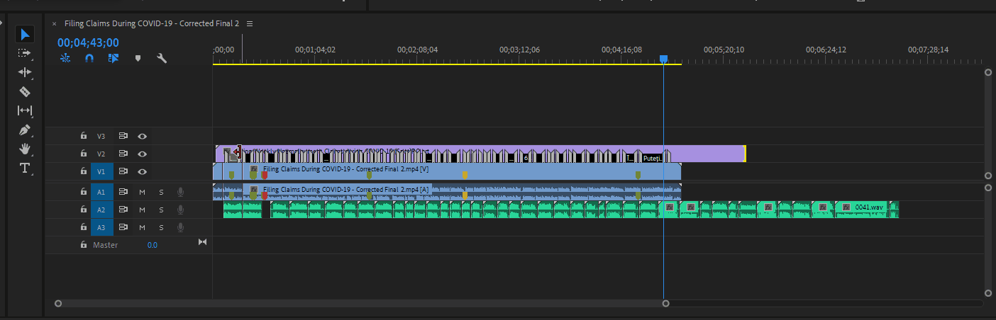

I'm working on subtitles for some videos in many languages, and I'm at a loss to figure out the cause. In some projects, I can ripple-shift captions by holding down Control and dragging one of the caption-handles:

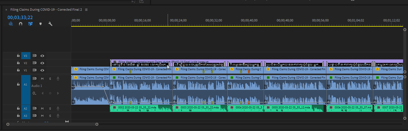

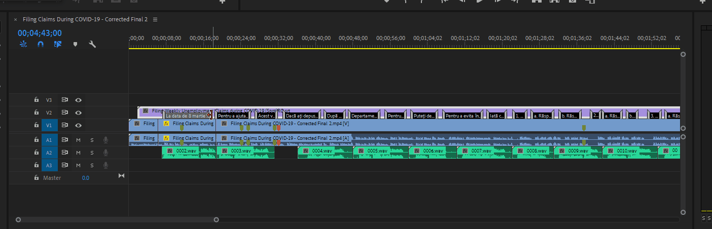

However, in other files, attempts to ripple-shift cause the shifted sub to glitch out:
I really have no explanation as to why it's happening. I'm importing .srt files, and I'm making them exactly the same way with the same tools (just SubtitleEdit, although doing it in Aegisub doesn't work any differently). I'm processing them identically once they're in Premiere (anchoring them all at once, messing with the vertical position, adding hard returns to break the subs into two or three lines). . It's not langugage-based, either - one set of Somali subs can be ripple-shifted without issue, but in a second video it glitches out like the Romanian above. IS this a Known Issue? My casual reading of the Premiere forums indicates that maybe captioning issues are common in Premiere.

The glitch appears to be the caption being extended snapping to a very long duration. In the middle screenshot, we cannot see the end of the caption stream, and the caption end snaps off screen. In the third screenshot, we can see the end of the caption stream, and it snaps to that location.
