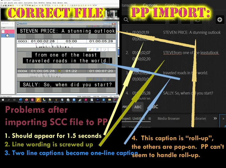

It's not just the timing that is screwed up when I import scc files to Premiere Pro.  It also messes up the words! Some of this seems to be due to the fact that the first caption with text is "roll-up," not "pop-on" like the rest.  PP can't seem to handle that.
