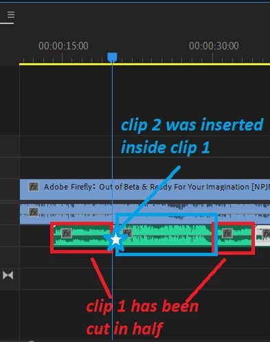

1) Prevent clips added with the code, from cutting in half already existing audios in the track, so for example:
var Times=[14,20,34];
You get 3 clips each one has a duration of 10 seconds.
If you insert clip 1 at 14 seconds, and clip 2 at 20 seconds
Then clip 1 will be cut after 6 seconds, leaving its second half AFTER clip 2.
I would like to know if its possible to prevent the second half from moving to after clip2. Meaning Clip 1 will simply keep part 1 instead of having part 1 and part 2 coming after clip2.

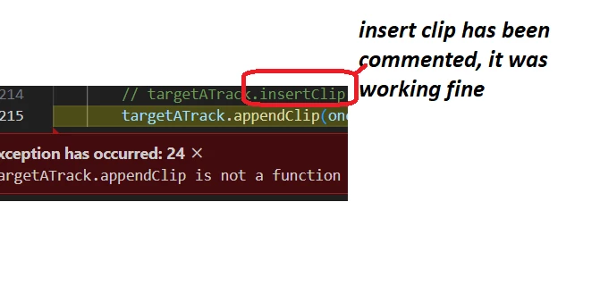

Hello BBB,
Solution 1) did not work, I got an error!
This is a screenshot of my visual code:
2) In and out, ok I will try that for solution 2.
Bruce Bullis
Bruce BullisCorrect answer
November 4, 2023
Sorry, my mistake; Track.overwriteClip(), not Track.appendClip(), is the other option.
