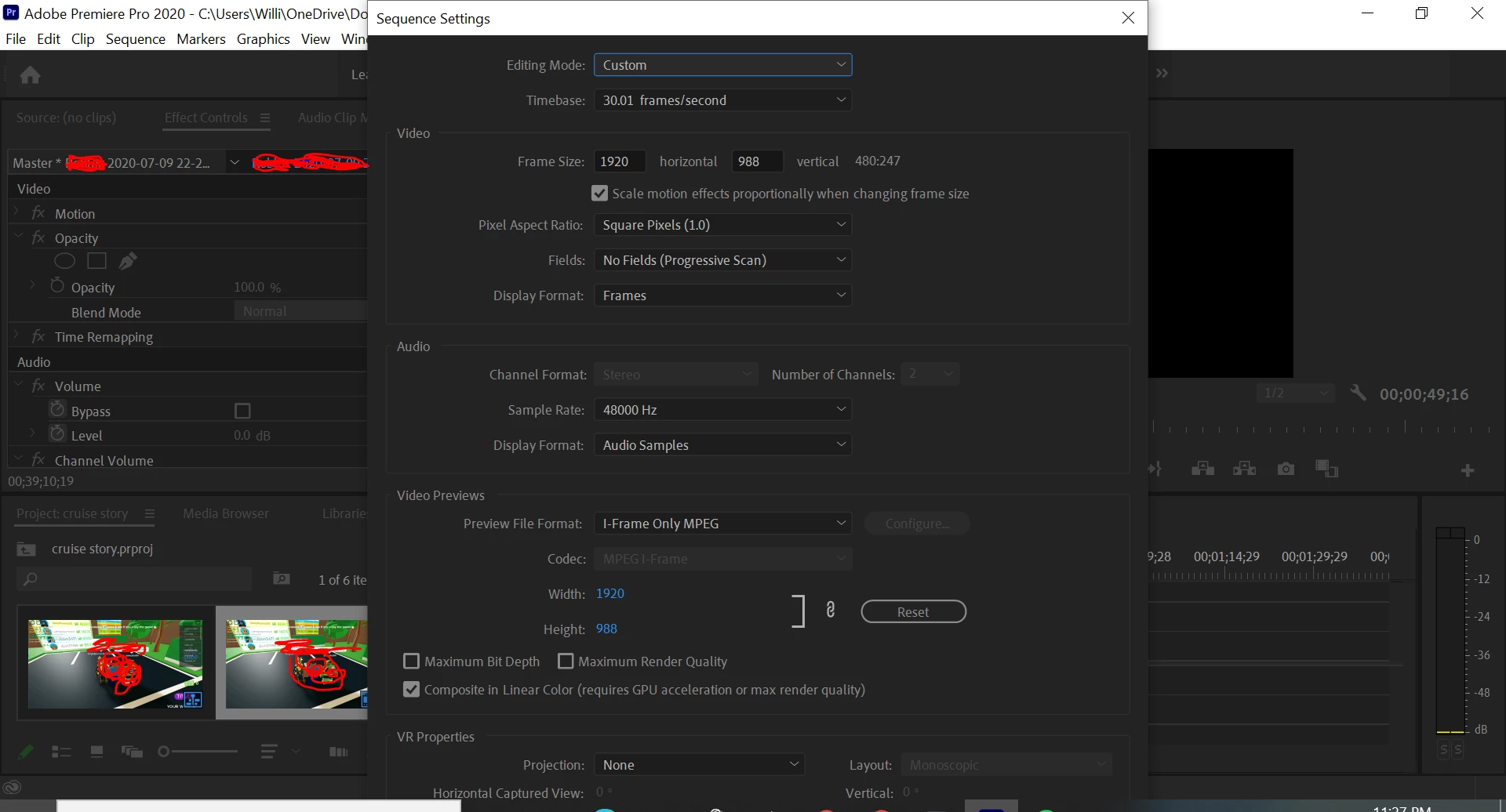

Sequence settings (or maybe other settings in general) window is too large to navigate in.
  • July 9, 2020
  • 7 replies
  • 8718 views
When I want to change the sequence settings in premiere pro, the window is literally too large for my laptop so I cannot reach the buttons below my screen, also I cannot resize the window too, I don't know how but I remember before resizing a window, but I can't do the same to the sequence settings. The window is also created in a way that it cannot go past the boundaries above your screen. Think there should be a fix for this or something.
Correct answer GAMING38634442az3a
I found a better solution,simply in display settings just set the scale to 125 Percent or 100 percent for me 125 percent worked perfectly fine

I have the same problem. Have tried all the suggestions listed above and nothing is fixing it / making it possible to save the settings. Have no idea what to do now.
August 22, 2024
Try changing the resolution of your display then
November 10, 2023
I changed the resolution settings on my laptop, which reframed the screen for me so I could see the button. Simply change the settings back once you are done if you prefered the previous resolution.
October 12, 2023
I just enocountered the same issue. The only thing I can do to bypass that is to use the TAB key and I press enter once its gone past all the possible options and the only thing it could be is the save/confirm button that you can't see. Hope that helps.
November 24, 2023
Thank you so much. I almost cried.
November 24, 2023
Do you think connecting to my TV can help?
July 9, 2020
And if you can't solve it by making everything smaller, remember that to accept a configuration in a dialog box you can always directly press the Enter / Return key.
Byron.
July 9, 2020
My screen resolution is 1920x1080
July 9, 2020
that's sufficient.   Have you tried resetting the workspace?  Also, I remember some posts about this issue.  Do some searching here...
July 9, 2020
that's probably the case, but let's find out what the actual screen resolution is...  I seem to remember this happening to me on my 15" macbookpro which did meet the minimum requirements.  Unfortunately, I can't remember the solution, but you might try resetting the workspace or connecting to an external monitor if possible...  and demaximize and remaximize the screen (not sure what the technical term for this is, but it's the icon at the top right to the left of the "x"
July 9, 2020
Yeah tried minimising window but it makes no difference to changing the sequence settings because it cannot be changed. I think that premiere pro should at least be compatible to all screens and have some calibration for resolutions or something.

That´s an indication of that your computers screen resolution does not meet the minimum requirements.
Read this: Premiere Pro system requirements
