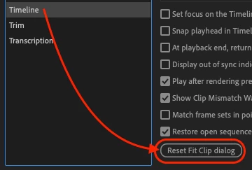

setting for when the source clip is longer than sequence in & out, decide if you want to use the seq
I was cutting in a clip that was longer than the sequence out point and got the dialogue box asking what behavior I want Premiere to do by default. I chose the wrong one and want to disable it so it'll bring up the dialogue box again. I forget how to do this, it's somewhere in settings I think but I can't find it. Please help.

Hi KazuTa,
Check out Preferences > Timeline and look for the option to reset the Fit Clip dialog or re-enable it. This will bring back the prompt when inserting clips that don’t match the sequence duration. I hope that helps.
Kevin

Hi KazuTa,
Kevin

Yeah, that's it. I thought it used to be a check box? Thanks again, @Kevin-Monahan.
