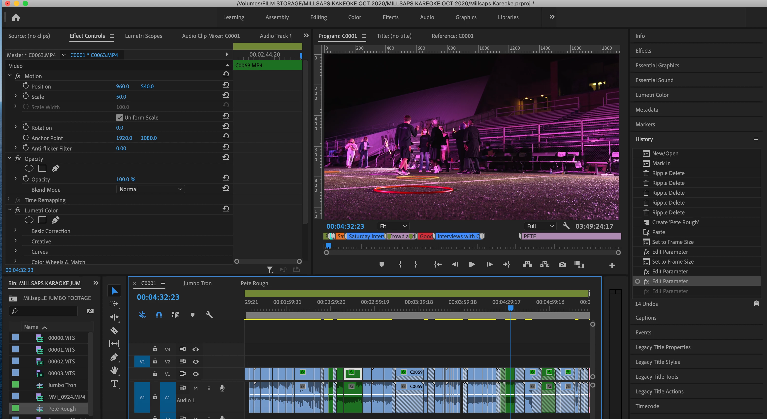

I'm trying to export a timeline sequence to an mp4. When I did export it--the timeline completely jumbled-whole sections of images were missing, clips I did not include in the edit appeared, etc. It was so strange...I have no idea why...
This is what the timeline looked like. So I went back to an earlier autosave and created a new sequence to export as an mp4 to a high-quality HD setting.

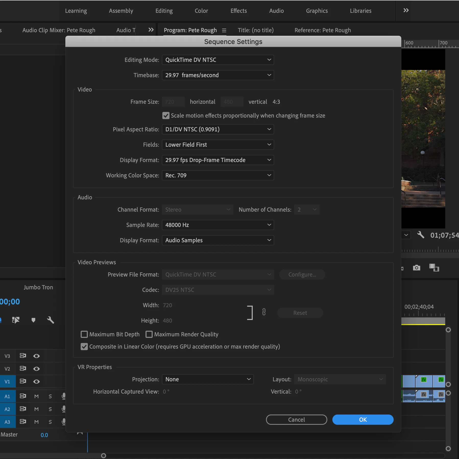

I wanted the image to fill the screen at 100% but it was set to the following below. When I try to reset it for 1920x1080--I get the following message. I'm afraid to select anything. Is it ok to follow-through? Thanks.

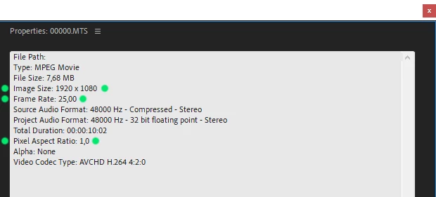

To start with, take a look at the properties for the footage and make sure that it matches the sequence settings.
This is what has gone wrong from start, you have editied on a DV 720x480, interlaced, Lower Field First timeline and probably placed 1920x1080 footage on it and use the Position/Scale to "move" the footage to the intended place in the video frame. Then you have changed the sequence settings to 1920x1080 but still keeps all other settings, iow Pixel Aspect Ratio to DV NTSC (0.9091), Lower Field First while it should have a Pixel Aspect Ratio of 1.0 and either Progressive or Upper Field First. This results in sections of video missing in export.
Thumb of rule:
If the footage is 1920x1080, 29.97, Upper Field First, the Sequence Settings should be 1920x1080, 29.97, Upper Field First and the export should be 1920x1080, 29.97, Upper Field First or 1920x1080, 29.97, Progressive if it is intended for the web.
When using footage X on a timeline with Y setting and export with a X or Z setting you will have problems and the export will look bad. Avoid any mis-match.
So make sure to know your source footage, right click on it and choose Properties. (See image below) Make sure that the Sequence Settings match the settings of the source footage. Then you have to manually reset the properties for the clips on the timeline that you have adjusted Prosition and Scale to get back on track.

The issue is not the setting you use when exporting, the issue is the settings and workflow you used when you started the project. 🙂

Any time you change anything about a sequence, any previews will be no longer useful, so it dumps them. No problem at all, they're just previews.
Curious about the non-square pixels ... any reason for the .9091 PAR setting? What's the media?

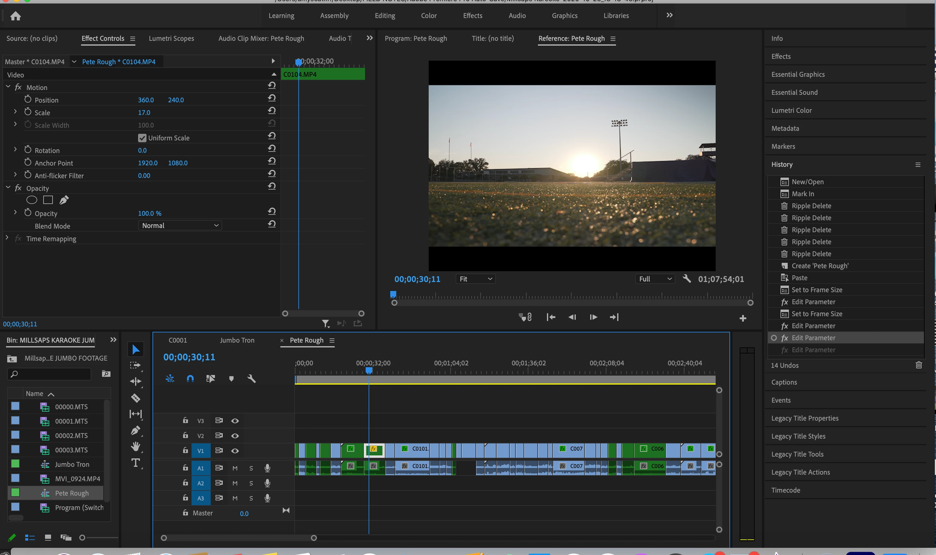

And what's going on in the area with diagonal stripes on clips?

October 31, 2020
I never figured out what happened with the media and the stripes--it took out a big portion of my project as I exported it. I think it was user error as I was copying the original media to another external drive for someone else to edit on the timeline and with the relinking, I messed up my file structure. Thanks for getting back to me.
