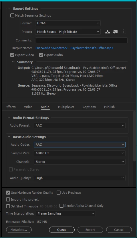

    Here are screencaps
    Although I don't think the export settings would matter as the exported result looks and sounds exactly as it appears in the program

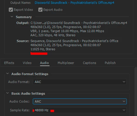

    So ... let's look at this screen-grab you posted ... just a part of it:
    Look at the source audio sample rate ... the original file ... 11,025 Hz. You can't select a rate that low to export from PrPro, the lowest option I know of is 32,000 Hz.
    My guess on that data bit alone is that this is a very highly compressed audio file recorded at a very ... stunningly ... low sample rate. Before coming into PrPro, which of course would have shown immediately in MediaInfo. Ahem.
    At that low a sample rate, it might play back ok, sort of ... but trying to re-compress it will show how little there is to work with.
    Please use MediaInfo on this and a few of your other clips, and get real data? That would be quite useful.

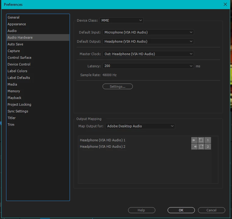

    R Neil Haugen
    Sep 22, 2017 1:34 AM UTC
    You didn't list or show any of your audio settings in the audio and audio hardware tabs of your preferences dialog.
    Please post in your reply a screen grab of each of those two screens.
