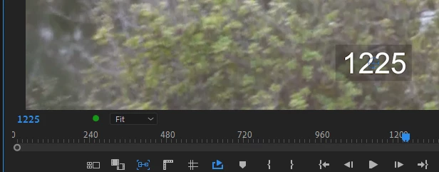

This is at the beginning (first frame) of the sequence when I use an Adjustment Layer:

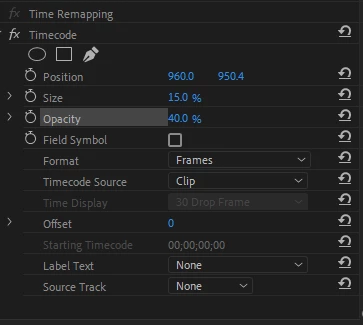

Right click the project and create a New Item, a transparent video. Put that on it's own track above all the other tracks and stretch it out to cover your entire timeline. Drop a timecode effect on it and set it as it is in my screenshot.
Only one clip to maintain, and you'd have to turn off the track (one-click on the track eyeball) when exporting if you don't want the frame numbers.

I gave it a try, couldn't get it. I tried the timecode effect also on an adjustment layer, that did seem to display frames but the number didn't seem to be relevant to anything? Then black video. That was closer but it covered everything. Finally I put a new layer on above everything else of Transparent Video, and dropped the Timecode effect on it, and it was displaying and acting correctly. It's a work around. You'd need to turn off that track when Outputting, but it seems to work OK.

It actually seems to work on an adjustment layer if I set "Source Track" to the track number, and then I can create one for each track to get a display like the overlay. That wasn't obvious, since when I tried to do that when the effect was on a clip it didn't work, so I assumed it meant something else (source track within a clip or something like that).  It's actually a bit better than the overlay, since it only shows up when there's something there, so it doesn't always show a bunch of useless empty "V2 V3 V4" lines when only one track is in use.
It still needs to be disabled, but at least it's just one layer to disable.  I'm definitely going to forget 50% of the time though, hopefully there are pre- and post-render scripts so I can automate that.  Wonder if there's something like guide layers in After Effects which do that automatically.
