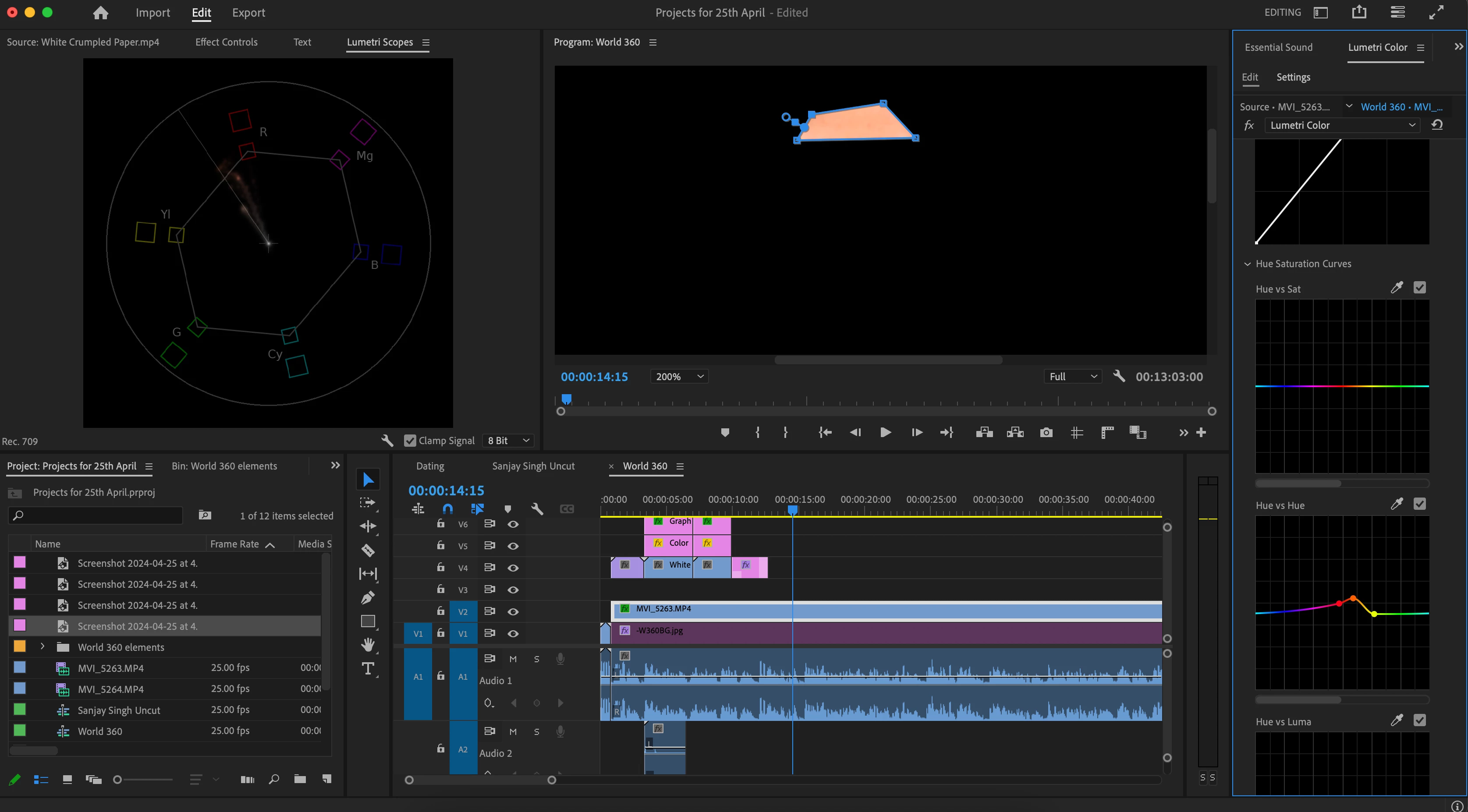

Hello everyone
While using the vectorscope to get the best skin tone, I see two color lines. Shouldn't it be just one? Wherein you use the Hue vs Hue color picker on the masked area of the skin and then correct the color to fall within the skin tone line.
I am seeing two lines of colors. Why is that?
Please help
Thanks

I'd guess there's a few red pixels in that selection, and you're just not seeing at this 'zoom' level in the monitor. That would cause this.
Everyone's mileage always varies ...

Hey Neilh
Thanks! How do I correct it? Should I sample a larger area?

April 26, 2024
I would suggest unmasking, then zooming in closer to see if you can see where the red pixels are coming from.
