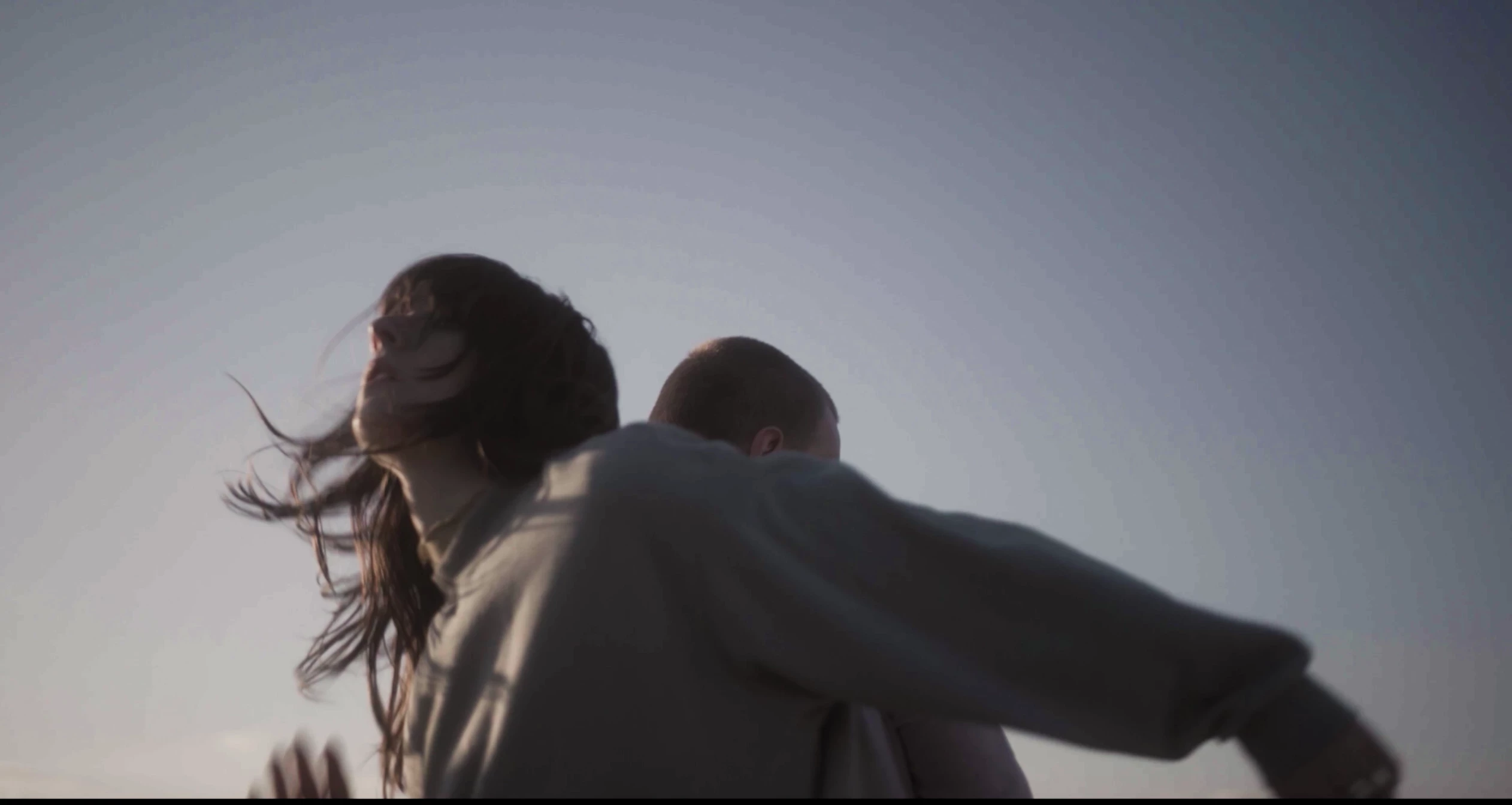

hi there,
I've got this super annoying problem with all my sky clips - (screenshot bellow)
I've tried everything from changing my sequence setting and my export settings too
any ideas where I'm going wrong ?
thanks a lot

May 16, 2021
Banding happens when the transition levels between typically low-change areas like a sky or a wall get dumped by the compression algorithms. Compression often takes say 4x4 blocks, and looks to see if they can make them all the same without "visual" damage to the file.
So some blocks may get slightlly moved one way on a channel or two, while the next gets slightlly moved the other direction. If you get several of theses down a tonal/hue transition area, then ... you see banding.
Getting rid of banding is very very difficult. And if you see it on clips coming into PrPro, before you've done any tonal/color changes, that indicates its really a big problem. I'm pretty versed in PrPro's Lumetri panel, the Red Giant Colorista plugins, and to a certain level working color in Resolve. I teach pro colorists how to work in Lumetri, among other things.
And I would find that file difficult to work with. There are times that adding "dither" or colored grain/noise to a file can help minimize banding. If in looking at the scopes of the image, either RGB Parade or Waveform, you can see that there are chunks missing primarily in one channel, there are times things one can do with a channel mixer ... though PrPro's is darn hard to use for this.
I know some colorists who would simply suggest masking/replacing the sky on something like this if you must use the shot. Yea, it can be that much of a problem. Yea, skies and light-colored walls can be a pretty daunting challenge at times.

R Neil Haugen
May 16, 2021
That is "banding". Rather common with 8-bit video clips especially. And also, especially a problem with 8-bit long-GOP formats, the highly compressed H.264/H.265 stuff.
Basically, you don't have enough data there to maintain enough levels for a smooth gradient. And there's not really a 'fix' other than shooting with more exactly correct exposure in the camera and if possible, shooting 10 bit.
So ... which camera are you using? What format/codec are you using? What about your in-cam setttings for contrast/saturation?
Neil
Everyone's mileage always varies ...
annau3120573
May 16, 2021
Hi Neil
thanks for such a quick reply - that was my biggest fear actually that it was setting in camera
it was shot on canon c200 I think ?? I didn't film it
so there's not much I can do in post ?
thanks
May 16, 2021
You could try adding some noise into the image to hopefully break it up? I know that's a trick when creating gradients in post. Admittedly I don't know how well it will do if that's burned into camera like that.
