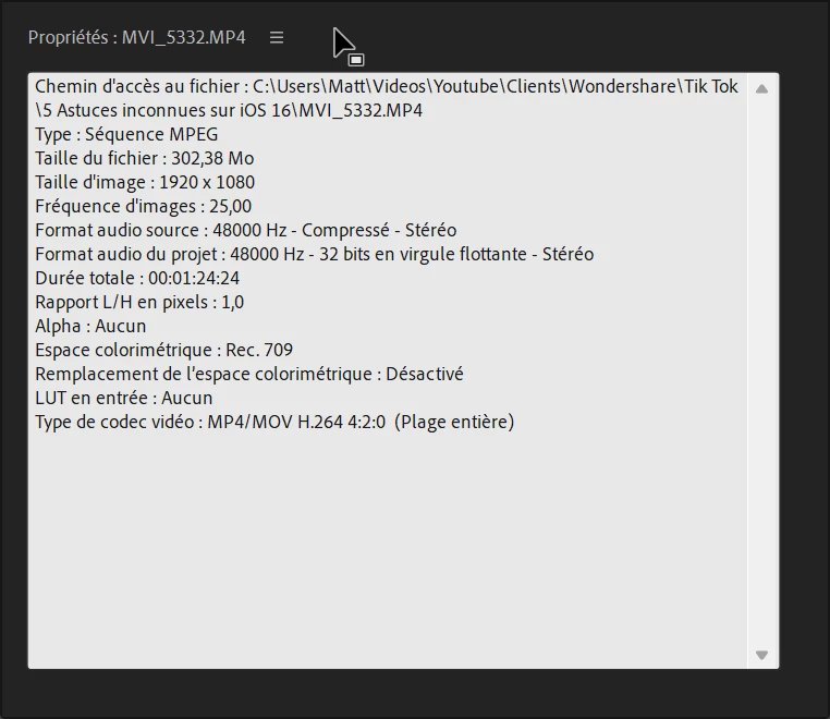

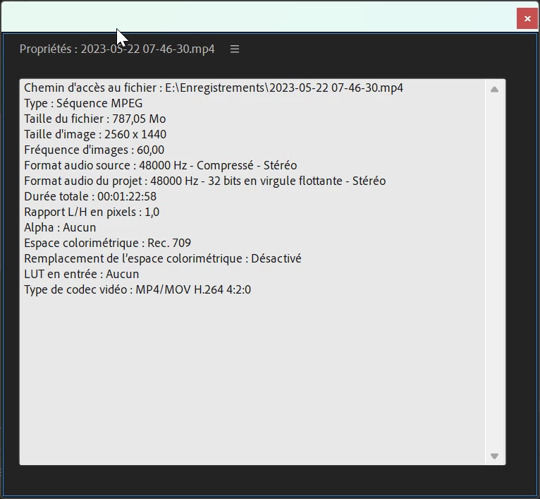

I'm working with HD Files (1920x1080) shot with my Canon Eos RP, I transfered those files to my SSD, and I import them directly into adobe premiere pro. Sometimes I upload some files shot with the canon EOS RP, linked via USB to my PC, and I record the files with OBS, as the one below wich has such propreties:
But I do have some files (Mostly, my talking heads) that have those settings:

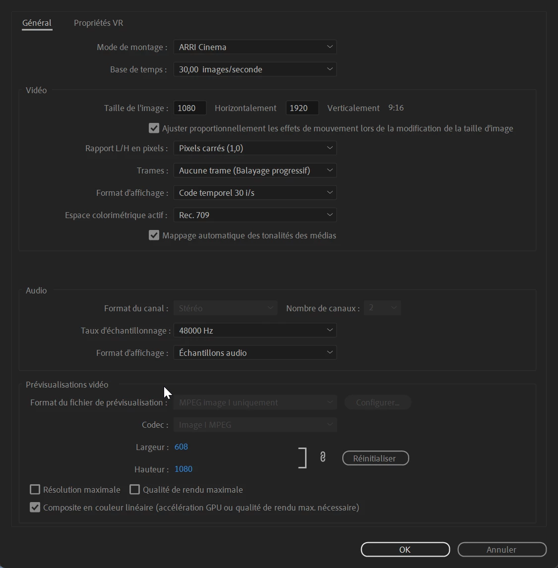

Usually, my sequence settings is 1920x1080 or 1080x1920 when I edit Vertical content.
And the other settings are, as below (see my screenshot)
