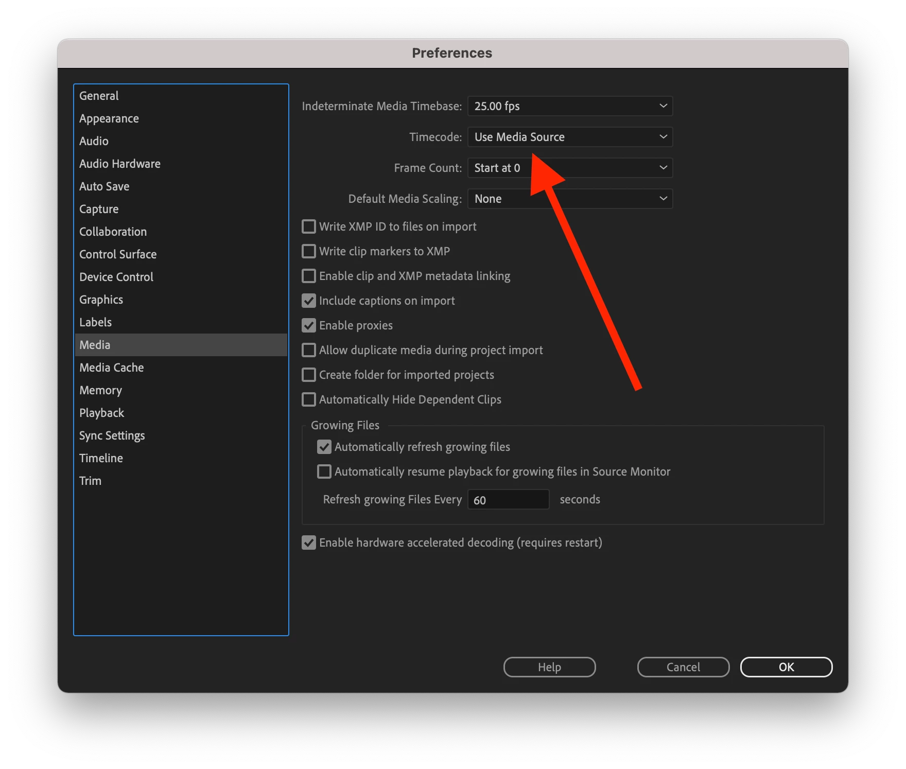

I assume you have this option set to 'Use Media Source'?
What format are the camera files?
October 19, 2021
Yes, I do have this selected
