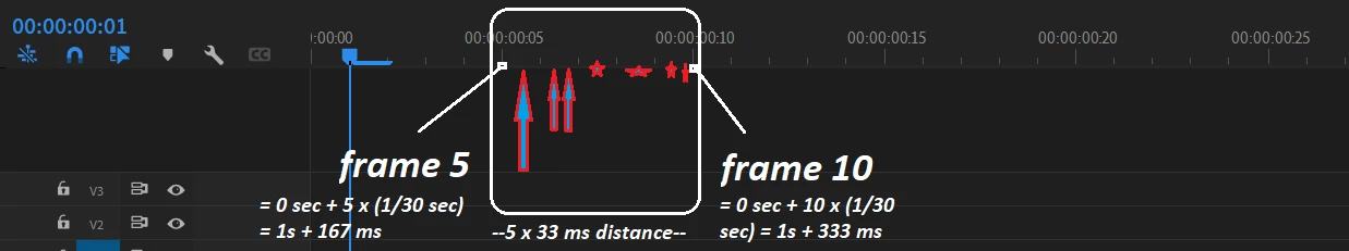

But even if I computed it in frames or any other metric, I am unable to insert a clip in between frames is that correct? Look:
Meaning , all clips must be separated of at least 33 ms (and its corresponding value in Ticks) right?
I mean even manually, you cannot move a clip in between 2 frames, the clip either in the frame before or the one after.
(In this example the clip will either be 00:00:00:05 or 00:00:00:06 you cannot put it between them = aka: you cannot insert a clip less than 34 seconds after the previous one, am I wrong? otherwise they will overlap, correct?
Edit: All the blue/red arrow and stars are areas where you CANNOT add a clip.
