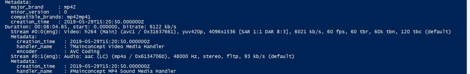

It's possible I'm not explaining myself correctly. This is what I get when i export using hardware encoding:
So the bitrate is a bit higher than I would like to use in my app but it is yuv420p, which is key.

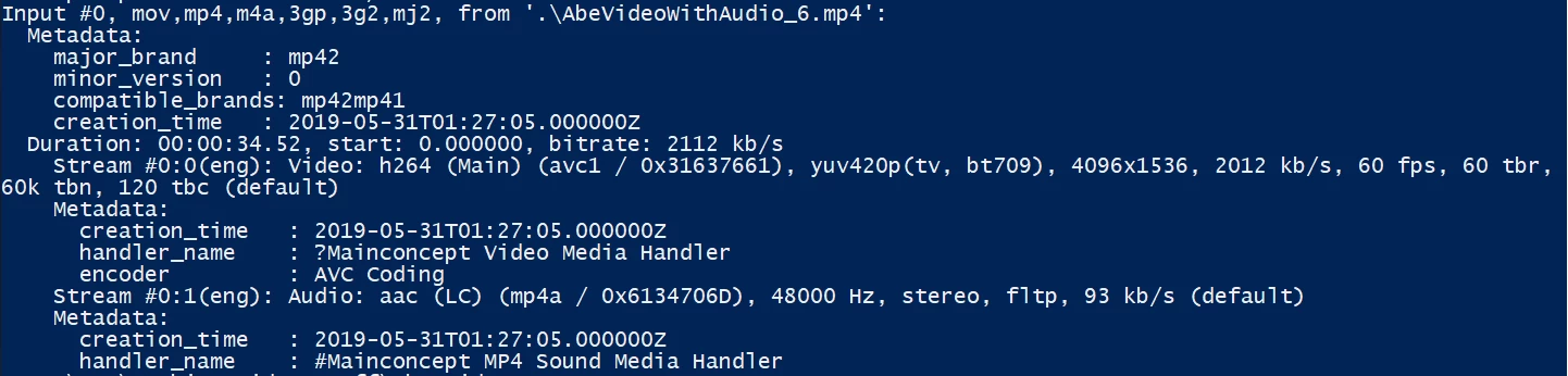

This is what I get when I export using software encoding (2 pass I believe):
Much more manageable bitrate, but as you see it's yuv420p(tv, bt709).
Using yuv420p tv limits the range of the data so it displays something like 16-235 instead of 0-255 which is what I'm seeking for this particular application.
I know it's not the standard but we make the camera and do the debayering ourselves in CUDA so the initial file is definitely 0-255 yuv420p, not yuv420p tv. I can show similar metadata on the source file if it helps find a solution.
